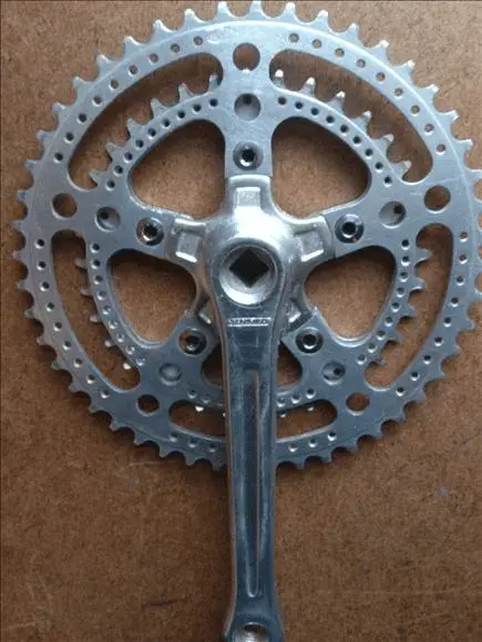

Yeah, mine look like that but no fancy drilled rings. So they're better or they're the spaghetti ones?

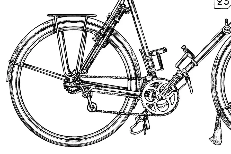

So how daft is 46/26 rings and 13-23 casette? There's no doubled gears except big- big near identical to small- small. I imagine it's really annoying to your pedalling to have such a big jump at the front.
Not daft at all. Actually that is a typical vintage French touring set-up:
The 46/26 would be nice for riding in a hilly or even mountainous area, but for me I'd want a larger cog in the rear for the really steep bits.

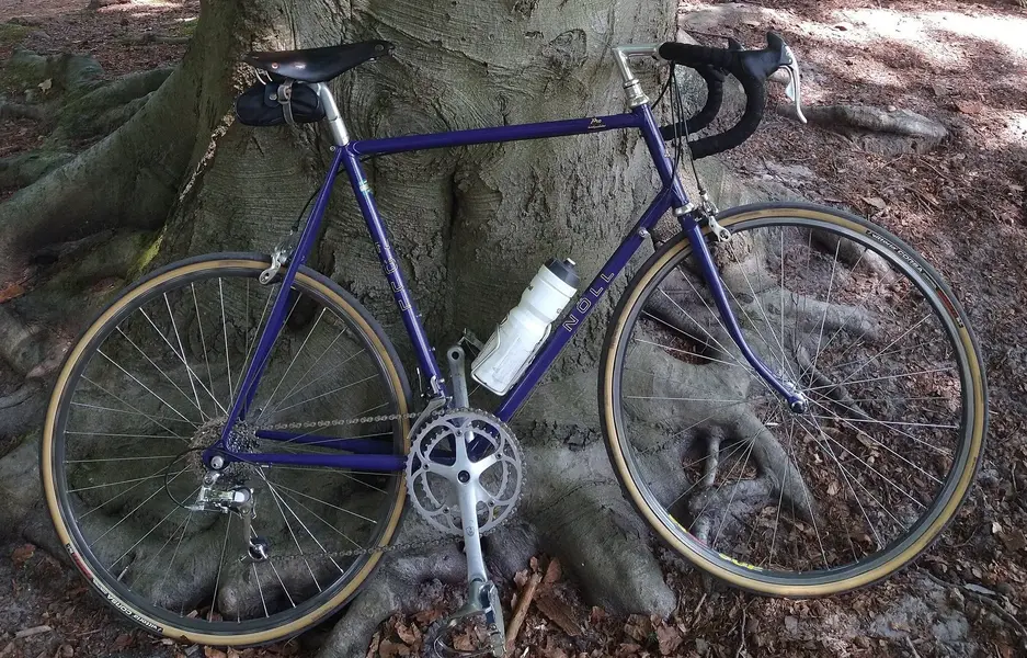

My own ride today, accompanying mrs non-fixie's test, was this German Nöll. Fitted with a 7-speed Shimano SIS rear end, shifted by early Campagnolo 9-speed Ergo's, using the hubbub cable routing. A nice and effective combination.
