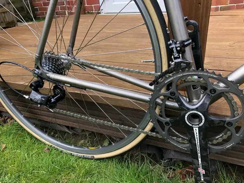

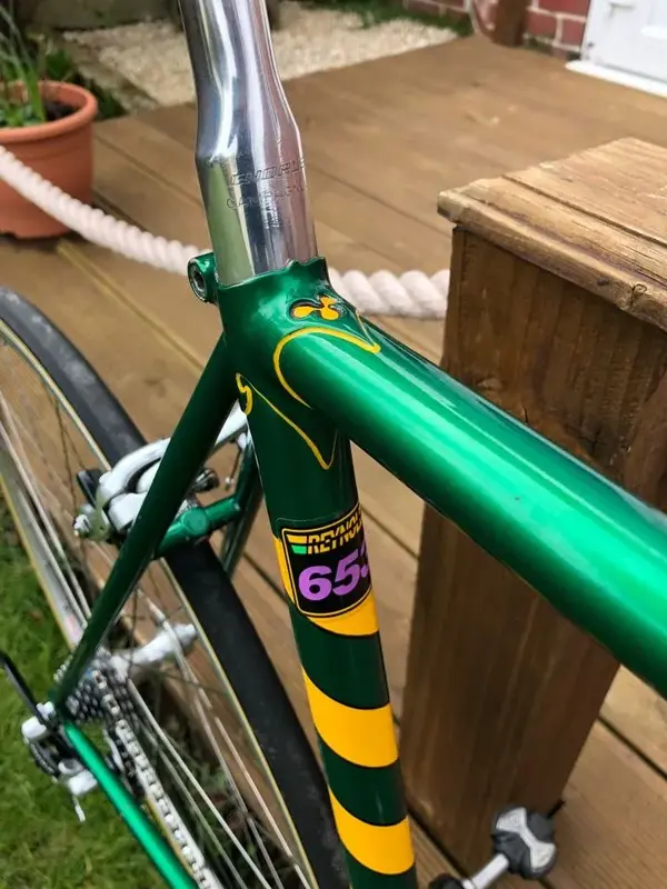

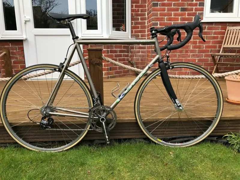

Couple of projects over the winter ready for the spring and summer.
Kona Haole titanium now sporting Columbus Minimal fork, 11-sp Record (with the odd Super Record and Chorus bits), Royce wheelset, carbon bar and seatpost, flite. Weighs in at about 7.8kg.
Mercian Strada Special with 10-sp Centaur groupset, more traditional finishing kit in silver, Cinelli bar and stem, Chorus seatpost with flite, Royce wheelset. Haven’t got a weight yet but a fair bit more than the Kona!
(Apologies for lack of pedals on the Kona, these bikes share a set!)

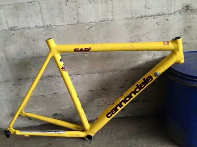

My contribution to this thread: Cannondale Caad3 with Shimano 105 5700.
I bought the frame for 20 € and was buying parts for 3-4 months to get what I looked for

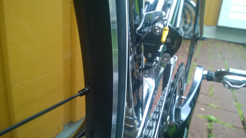

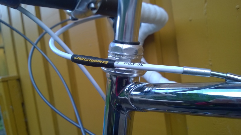

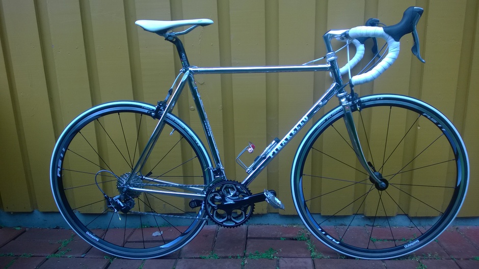

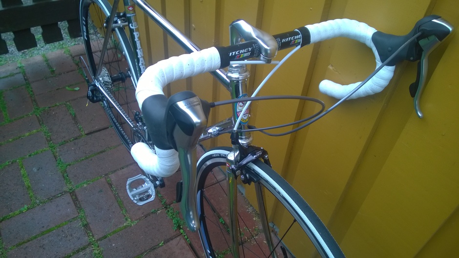

Made this one for my son to ride. Shimano Ultegra/105/Rs500/rs11(wheels) and Ritchey wcs parts.
No big problems with setup of 10-speed Shimano gears. I used gear cable liners inside frame tubes. Would have needed special ferrules for rear brake cable inside top tube.Made my own from old v-brake noodles.
Ride is super smooth with Vittoria rubino pro 25mm tires.
Bike weight is 9,6kg with pedals.
