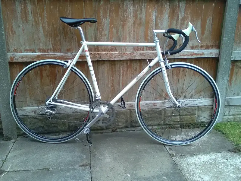

I'm modernising mine gradually. I've changed the wheels to more modern ones and the rear mech. I may change the brakes next for dual pivot and then maybe change to 2x10 with sti's.
