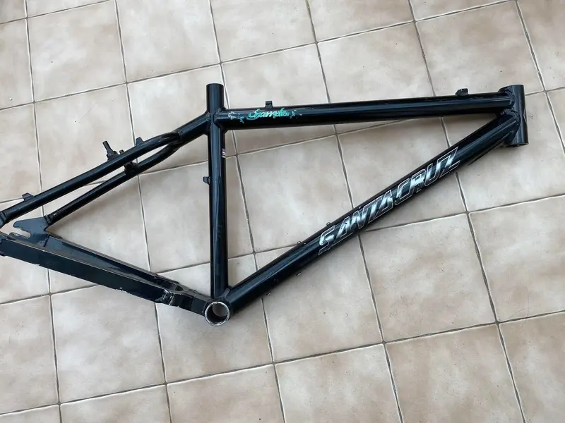

Pics incoming. Building from frame up so looking to get a 98/99 era build parts wise. Paul Smith had a black Chameleon in MBUK back in the day in an article about using speed bumps to practice. I always wanted something similar back then but my 19" Kona Hahanna was my only realistic option.
I'm thinking a sort of play around the woods JMC type build.
It's a medium frame, tempted to have it powder coated black or red as current black paint isn't great.

Frame has arrived! Love the lines/angles. Paint is kinda bad. Decals even worse. Waiting to see if Gil can do the decals specific to this version and thinking of a powder coat. I like idea of sticking to black.

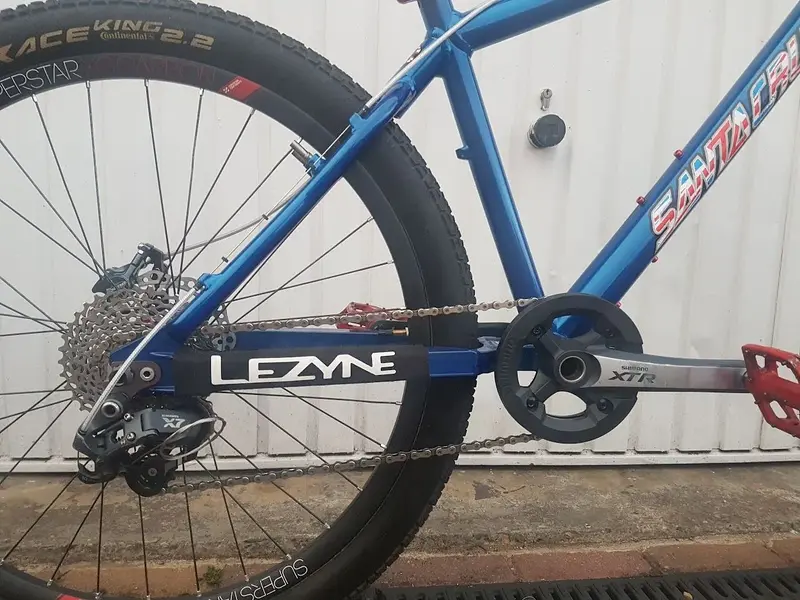

I understand the whole 'period correct' thing but chain devices were a pretty crap solution to a problem that has been resolved with clutch mechs and narrow/wide chainrings. Even without a clutch mech the N/W chainring is unlikely to drop the chain and you don't have all the weight, noise and drag of a chain device.
The picture is of my bike with a n/w chainring and a plastic shimano bash guard 20180902_191208.jpg
The picture is of my bike with a n/w chainring and a plastic shimano bash guardView attachment 666842

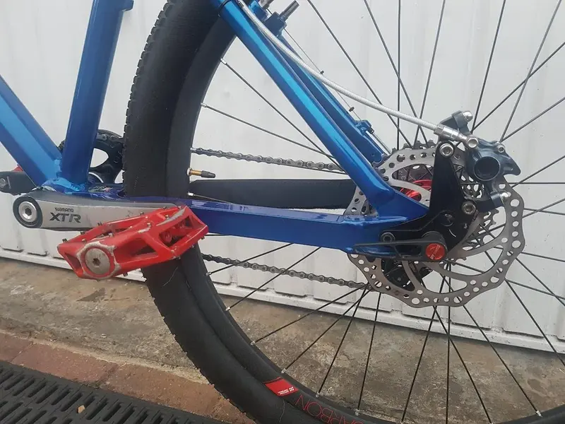

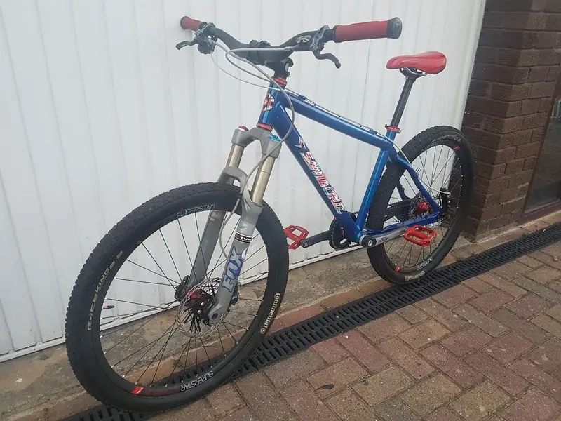

Good to know. If I can just run a single ring with no guide and the mech/ring will do the job, that's ideal. What cassette/mech/hub/ring are you running?

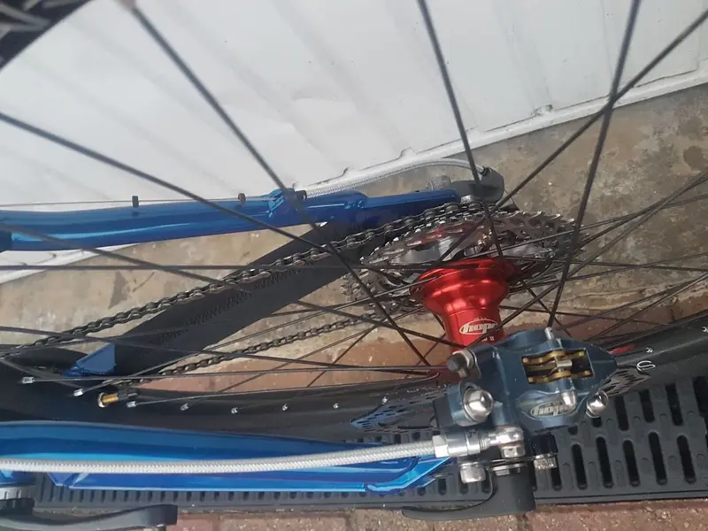

Mine is a little unusual. I am running a Hope Pro II hub in the 135mm x 12mm configuration. I drilled out the dropout to accept a 12mm axle and using a DT 12mm axle. This was mainly to secure the disc adaptor, which is held in place by the axle and a chainring bolt (I drilled an extra hole for the chainring bolt).
The gearing is 10 speed SRAM X7 shifter and mech with a SRAM cassette. The older non-clutch SRAM mechs tended to have stronger springs than Shimano mechs, which were always a bit sloppy
