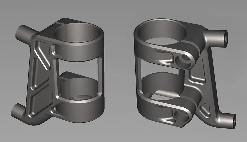

Or if you want to do a trade, I have data for a Syncros crank Stress Transfer Device that I need CNC milled in either 2024 or 7075 grade aluminum. I need two of those. It's a small part that can be milled 3-axis (fairly straight forward) but I don't know if you want to bother with it. (in that case your part would be free, we'll do an exchange). I can send you the data if you want to evaluate it for machining purposes.

2024 is what we have in the shop ( HE 15 ) , 7075 T6 is a little harder for me to get hold of !!! I can look at the job , just me at the moment on the shop floor , what sort of size is the job , we use igs files if that helps , will look at the job don't hold your breath , i would rather pay for the parts now and not let you down .
That's why I said probably buying the parts would be easier for you than machining those plates. ( the size is fairly small; 3"x1.25"x0.5") 2024 grade aluminum would work very well. Send me your e-mail and I can e-mail you the igs file.

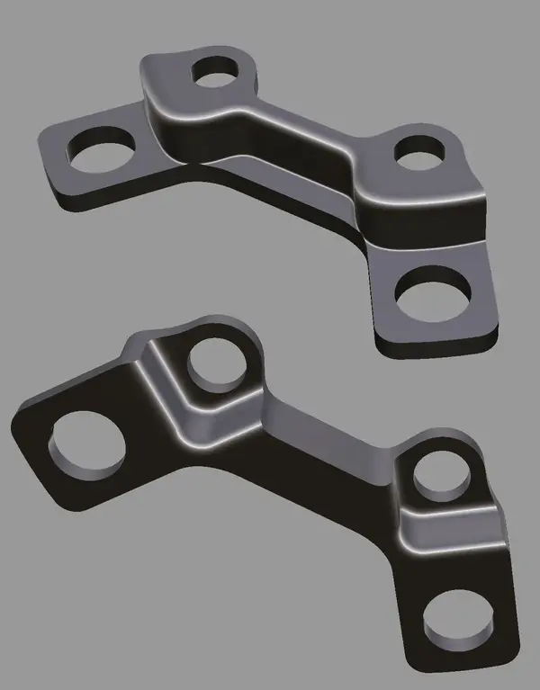

If you can run CNC, I have a model of the adapter which I made. Solidworks, but can be STEP/IGS etc:
It's been altered from the original Fournales one so that it is ISO2000 standard 4mm offset face and clearance for the rotor bolt heads at the bottom.

That's cool! I know I will have to deal with butchering one of the original disc adapters to run discs with my second fork.
