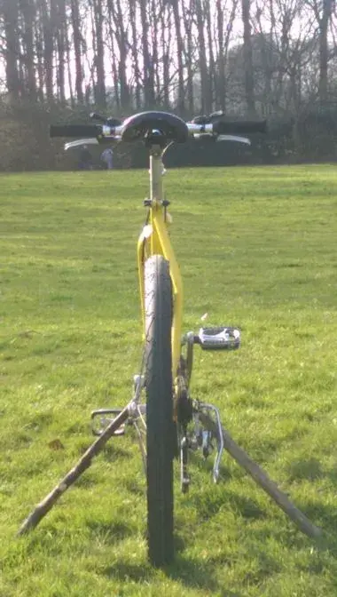

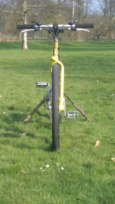

The main issue for me is the alignment of the entire rear end. The front of the rear wheel is pointing slightly to the left, possibly a result of chain pull over the years. Also, both wheels are slightly out of center too, so they either need re-dishing or could benefit from rims with out-of-center holes. The combination of those issues means it's not really tracking straight.
Curse you all ... now I'm interested in it again and throwing money at it ...
I did some more searching and EBC has a model of brake shoes that might fit, so I just ordered a pair of those. Fingers crossed.
Also, after a long conversation with one of the mechanics at my nearest LBS (to decide if it's worth keeping or if I should just sell it), he and his boss had a look at it and decided that the problem isn't as much in the rear as I thought it was. Of the 4cm misalignment, they reckon 3cm is in the front.
They may be right ...

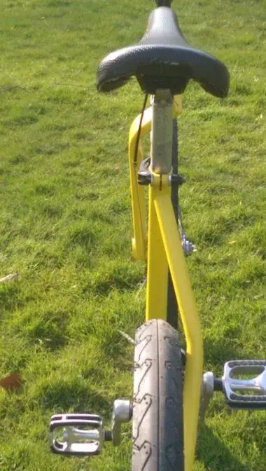

The above pics don't reveal much IMO. However the one below does.
It's clear that the front wheel and seat tube are not at the same angle. Not even close in fact.
According to my mechanic, the bend in the fork is the culprit here. it's too weak to take the stress of serious off-roading. A few hard landings will make it bend inwards, which is exactly how it's pointing.
I think I'm going to try the bike with a regular fork first, to see just how much that improves things. Then I can make up my mind on how to proceed.
