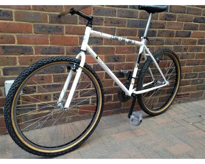

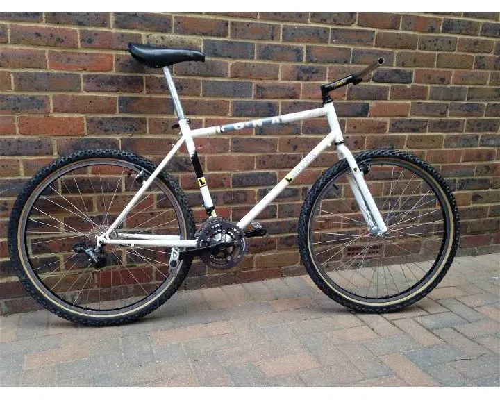

OK, minger #2 has arrived at SP towers. Unlike the 1994 Cinder Cone this is the correct year and geometry. However despite having the same length seat tube as my 1990 Cinder Cone, the head tube is 6" - 1/2" shorter. My Fire Mountain head tube is also 6" so I assume the Lava Dome and Fire Mountain are 19" as per the catalogue and the Cinder Cone is a 20" I will compare the top tubes at some point.
I bought this old dog from eBay : http://www.ebay.co.uk/itm/Kona-Lava-Dom ... 7675.l2557
I have great reluctance to re-spray the splatter paint frames as they were hand finished but as this is boring white who gives a fig? After the seatpost gave up I could see that inside it was pretty clean and solid. The marks on the chainstay are superficial and with a bit of prep before paint shouldn't be noticeable. Racin'snake had some great karma and sent me a set of wheels, the seat post is on it's way, as is a chain. The tyres are some Z-maxs' that are a bit crispy but ok. I REALLY need a new stem or a top-cap for the Velocity stem pictured - please help! It is a 1" headset, needs a cable hanger preferably and ~120mm long.
The plan is to build it first then ride it a bit. IF it suits me then I think a black powder coat and a set of fresh Lava Dome decals will be in order. I will then splatter as per the Explosif - i.e. it'll have an Explosif paint job but still clearly a Lava Dome and a unique one at that. :D The Suntour stuff will get sold on and replaced with some lovely period Shimano.

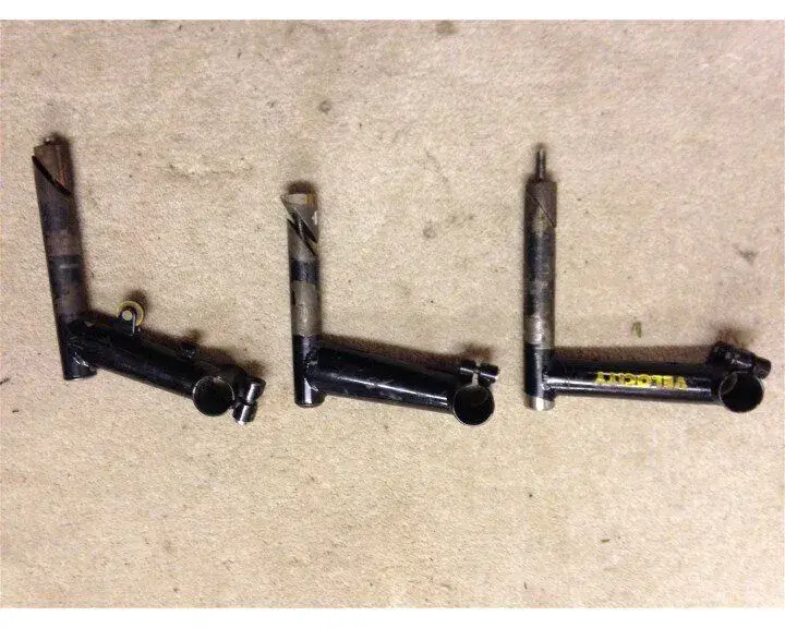

➡️ My Dad machined a new stem top plug out of stainless steel to resurrect a Velocity stem as the original ICR one had cracked :( The stem plug took ages to machine and had to be made out of two pieces and silver-soldered together - cheers Dad :D
➡️ Thought long and hard about the build - but not made any decisions :facepalm: I did buy some DX brakes cheap though! I have a donor bike lined up on eBay so need to get sniping....
Stems below, Velocity from the Explosif and Cinder Cone, the ICR from the Lava Dome and a Fire Mountain stem, all from 1990.
Re: Kona Faux-splosif - new donor bike here...
Please excuse my naivety - I just assumed that Velocity stems were all 1 1/8th" - I have recently developed an interest in getting a Kona from the Joe Murray era - when did the headset go over to 1 and 1/8th?
