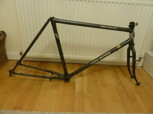

Just after arrival...

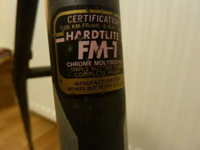

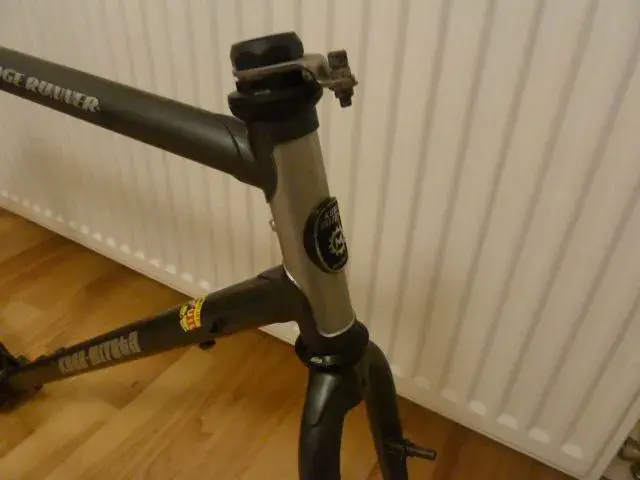

First thoughts after unpacking were that it is truly beautifully designed and finished. Triple butted cro-moly with spiral butted tubes and forks that ring like a temple bell when you flick them with a fingernail. Miyata made guns before bicycles so the spiral butting will have been a carry-over from gun barrel rifling. Low rider rack mounts on the front forks point to its touring heritage.
The 1986 catalogue shows a Ridge Runner with this paint but cantilever brakes front and rear. I guess this means they changed the 1986 model to U brake after the catalogue was printed. It also has no bottle cage mounts under the down tube, unlike the catalogue picture. There was no Ridge Runner in the range before the 1986 model year. (And thank you Koga, for keeping your catalogue archive online!)

It must be the 21” version as it measures 50cm c-c on the seat tube, from BB to mid-top tube. They also did a 23” one. I am sincerely hoping this will fit me with the right stem and bars. I’m just under 6’ but on holiday in the Netherlands this summer I felt quite short amongst some very tall Dutch folks. Anyway, it’s got a similar top tube dimension to another couple of my mid-eighties bikes.

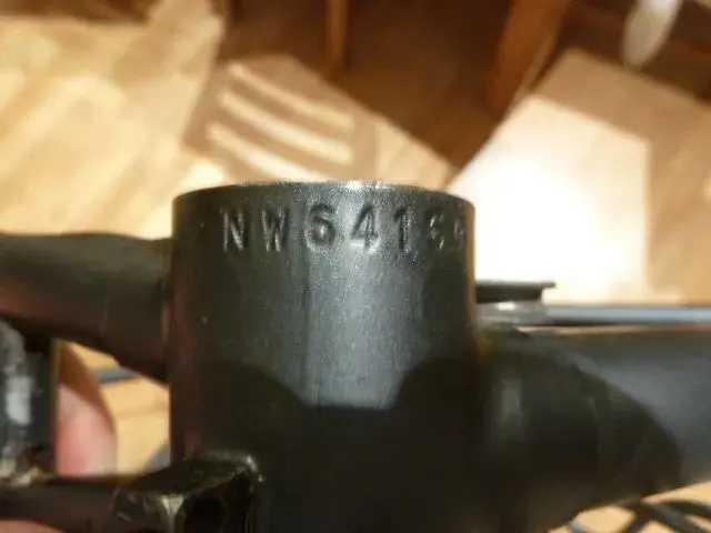

The frame number on this bike is NW64150. According to an Asian Serial Number database, the N means 1985 and the W the 26th fortnight, so it was made 15-28 November 1985.
https://classicjapanesebicycles.com/general-asian-serial-number-guide/

First step was to find and fit a suitably high stack 1” headset. I had a BBB cartridge bearing headset from another frame which will do for now. Nowhere near period correct but looks ok, I think, and is nice and smooth.
Before fitting the headset I weighed the frame and forks: frame is 2.6kg, forks 0.93kg.
Now fitted with a BBB 1" cartridge headset. Lugged forks - sturdy!

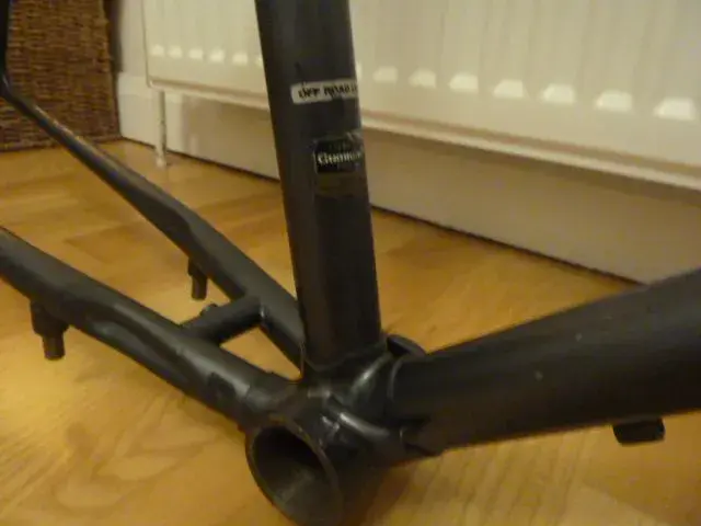

Happy days, or until I tried fitting the bottom bracket. Drive side cup went in nice and easy. As did the axle and non-drive side. But then it kept going in until it was no longer projecting enough to fit the lock ring once all the play had been taken up. Hmmm. Who’d have thought Miyata would have used a 70mm bottom bracket shell!

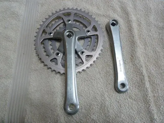

Biopace chainrings refitted. But not on the bike until I sort the bottom bracket!
