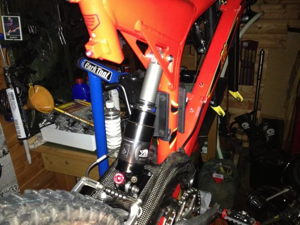

That shock is too short. The standard Noleen shock length was 209mm I to I so yours will drop the back end too much. If you want to change it out for a Fox then the one to use is a 215mm. You have to invert the shock to fit it without frame alterations and Mojo suspension can supply the bushes. Top bushes are off the shelf but bottom bushes have to be turned down by a few MM each side. It doesn't affect the shock in any way running it inverted. If you are using crosslinks on the front then you can just run 5mm more sag in the rear. If you are going to use a modern tele fork then it will sit the front higher than the crosslinks so you can tune the rear to suit.
Here's the Fox float on my 4000 with crosslinks up front.
My 4000 and my Oz with Fox RP23 shock and Fox Talas forks.
Fit a Fox, it transforms the bike.
