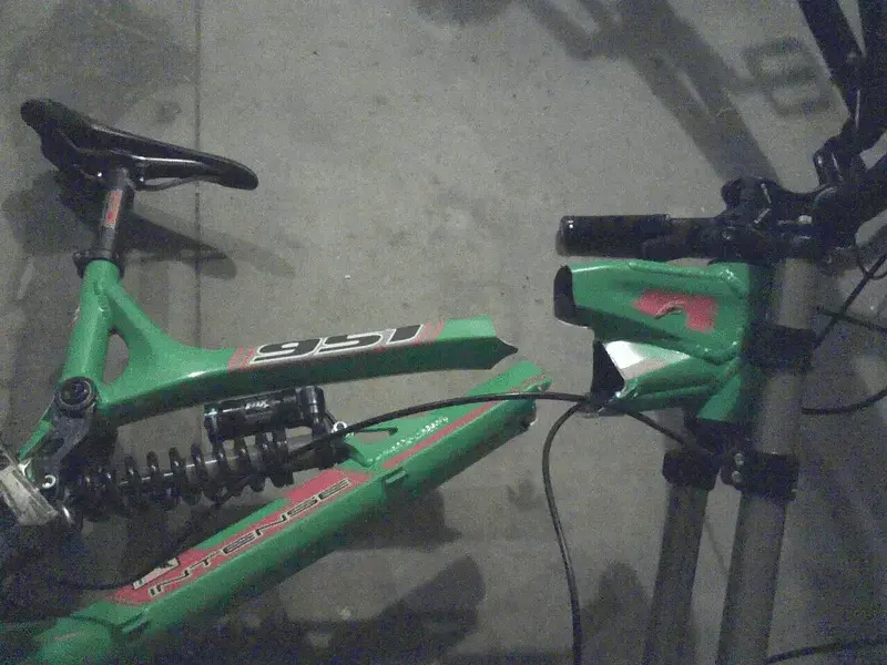

Note this small fatigue crack in an aluminium Intense frame - happening to a number of Commercial Supremes too....
