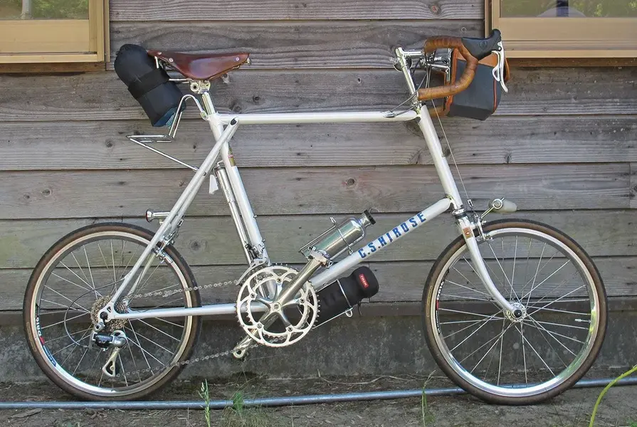

Wow .. there's even a Mini René Herse..😱
