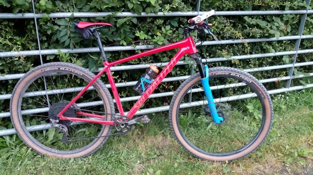

M980 will be nice, and imo the 970 cranks would still go nice looks wise, they are also nice and light. Ive still got my old 970 equipped Kinesis, and despite everything being worn out, its worn together and still rides spot on. Superstar components do a nice range of chainrings that are pretty cheap, ive got a 38 on my XT gravel bike, and ive just ordered a 30 for the race bike so I can run my xtr cassette.
I suppose the key thing with going 1x is you are making a compromise to match up with the rider, rather than the 3x or to an extent 2x than having a gear for every rider in every situation plus duplicates, weight and mud collection.
I think value wise, money would be best spent on the biggest cassette as it will wear to the chain quicker. A 32 chainring would probably be best to start with, then if you really don't get on, you can easily drop down to a 30. but honestly, most peoples go to is a 32.
Regarding tapered head tubes, Its case of lots of small gaines, rather that one thing being an epic gamechanger. Get on a modern thru axle bike with tapered head tube and it will feel so solid, and therefore more planted, predictable handling and more trust and feel in the tyres. From a design point of view, the tapered head tube is stronger, so can be made lighter, my new RS SID ultimates weigh in at 1670 grams! when you are chasing every gram, it makes a difference (I will save over 100 grams when I refit my xtr cassette in place of the Suntour boat anchor.
I was racing on this last night, I really love it, it just suits me perfectly.
