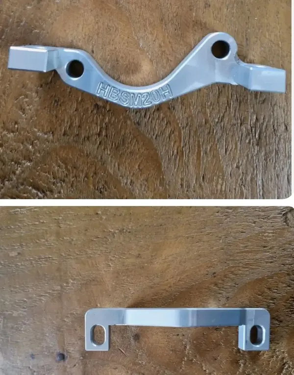

I've just bought a set of Hope mono M4 brakes, thanks whiskytownracer, but didn't give any thought to the fact that these are IS mount and the bike I plan on fitting them too is post mount front and rear. It currently has SRAM level.
I pretty sure that this adapter below is correct, but would like some confirmation, would it be the same front and rear, different rotor size though.
Cheers.
Yes for the front(HBSM20H), and yes to adding 20mm to the rotor size, but no to the rear, for that you need a different adaptor, -HBIS20. It also increases the rotor by 20mm.

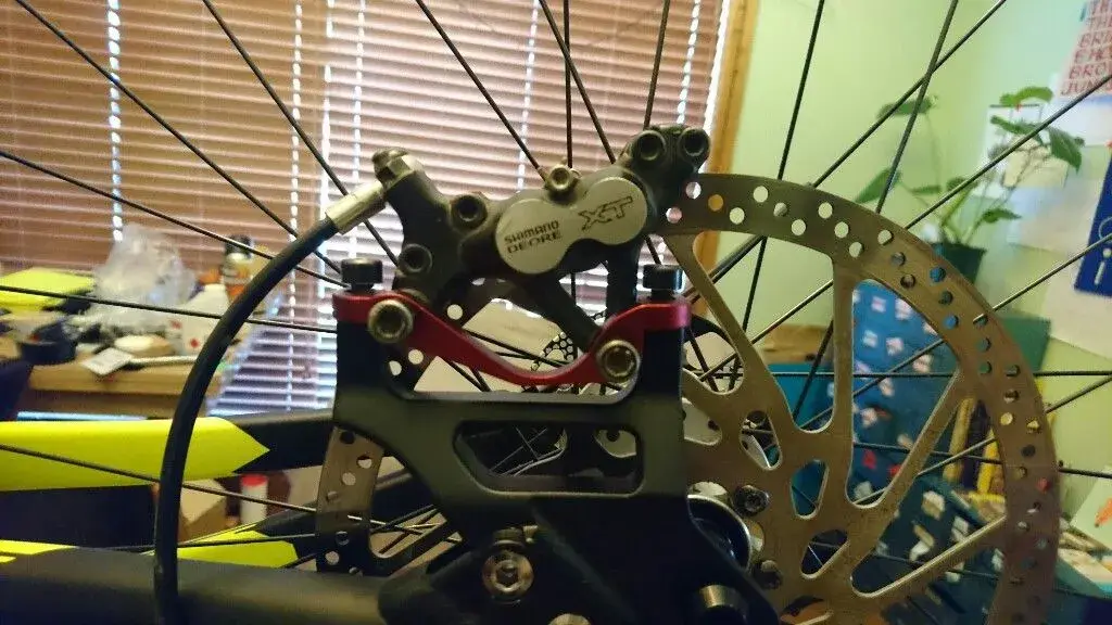

Below is a 160mm rear Shimano M755 caliper on 180mm post mounts with a 203mm rotor.

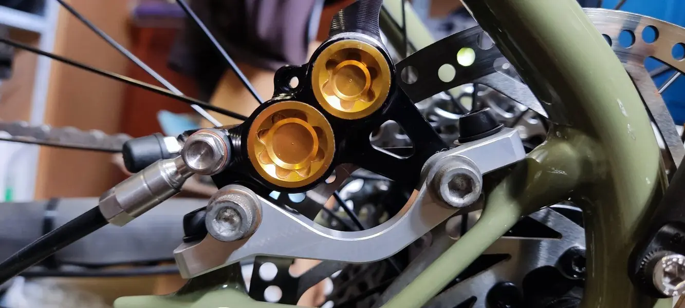

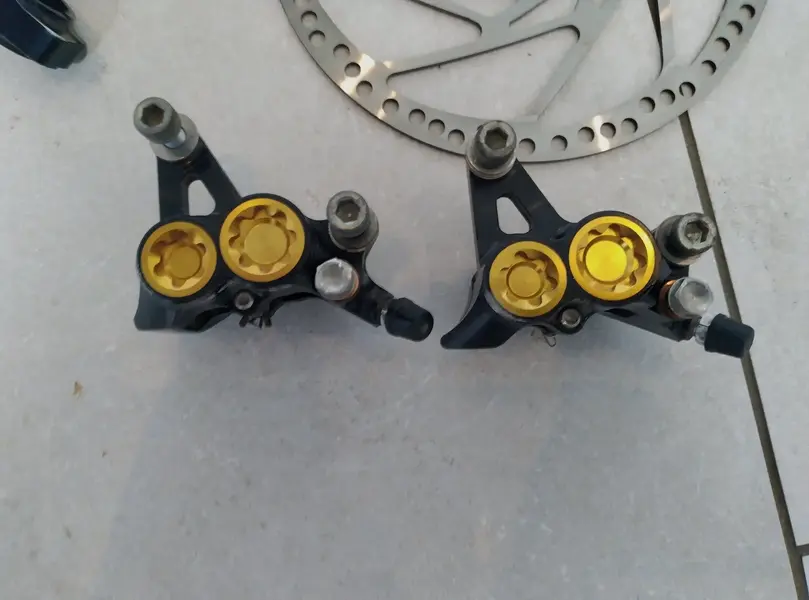

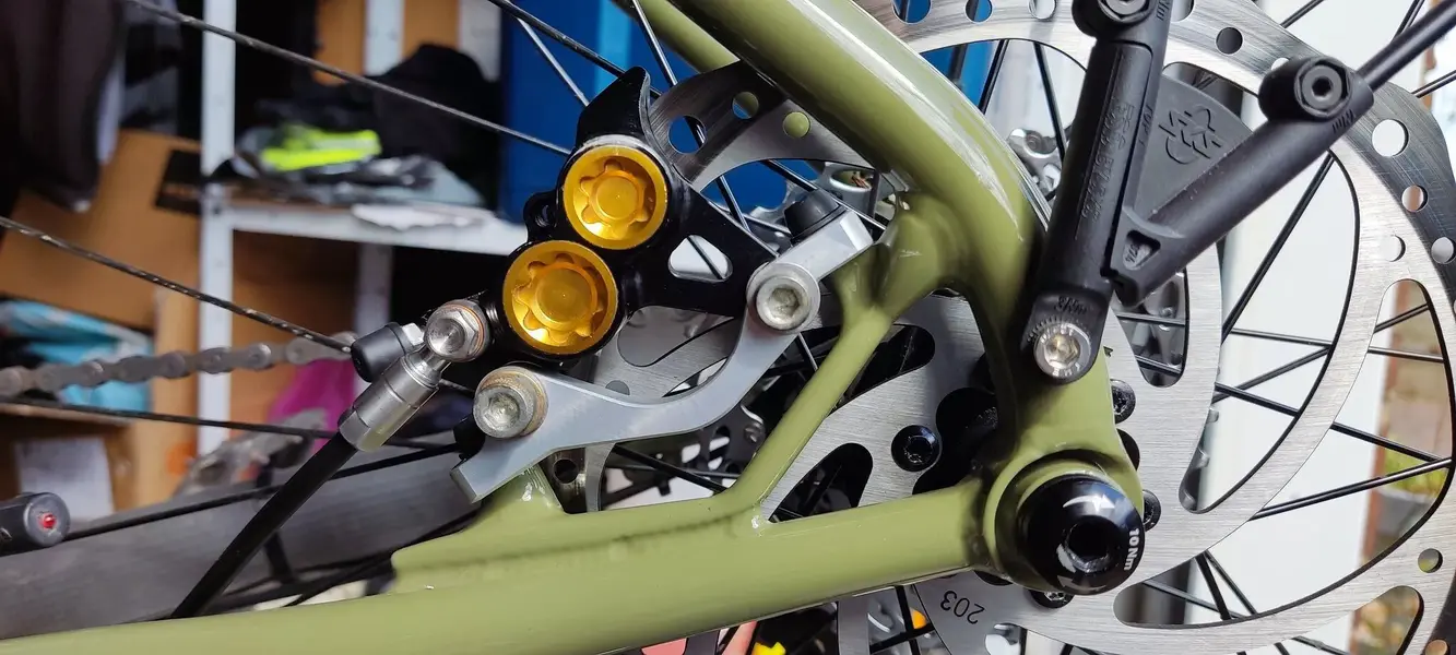

So I finally got around to fitting the brakes, front is fine, adapter and 200mm disc, works a treat, the rear however, same adapter, looks like it'll also need a 200mm? I removed the SRAM brakes and 160mm rotor, presuming that a 180 would work, but no. It's during me mental. I'll take a pic. I'll try the front rotor for size before heading off to find a another, bugger.
