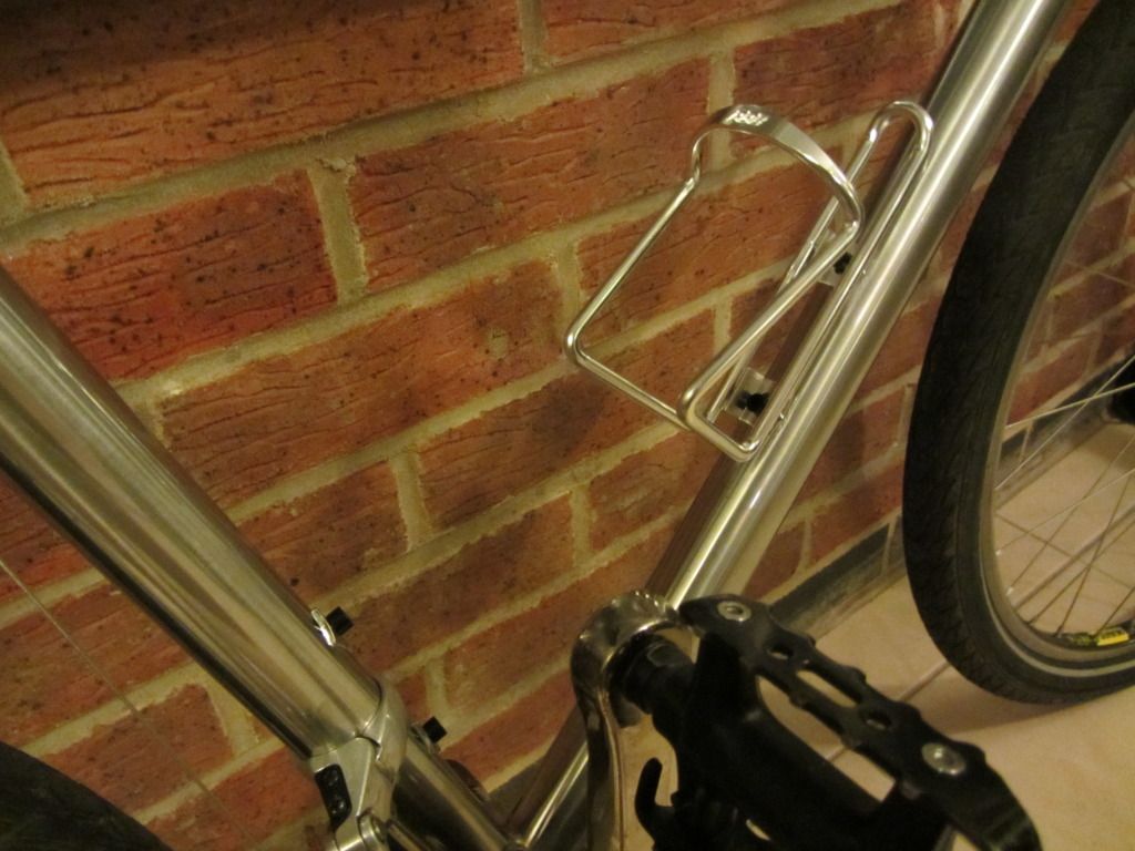

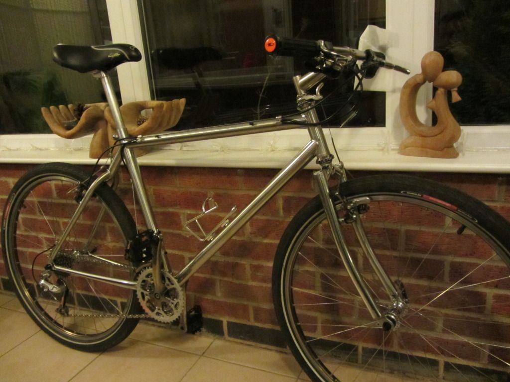

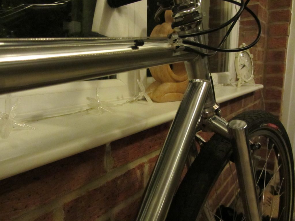

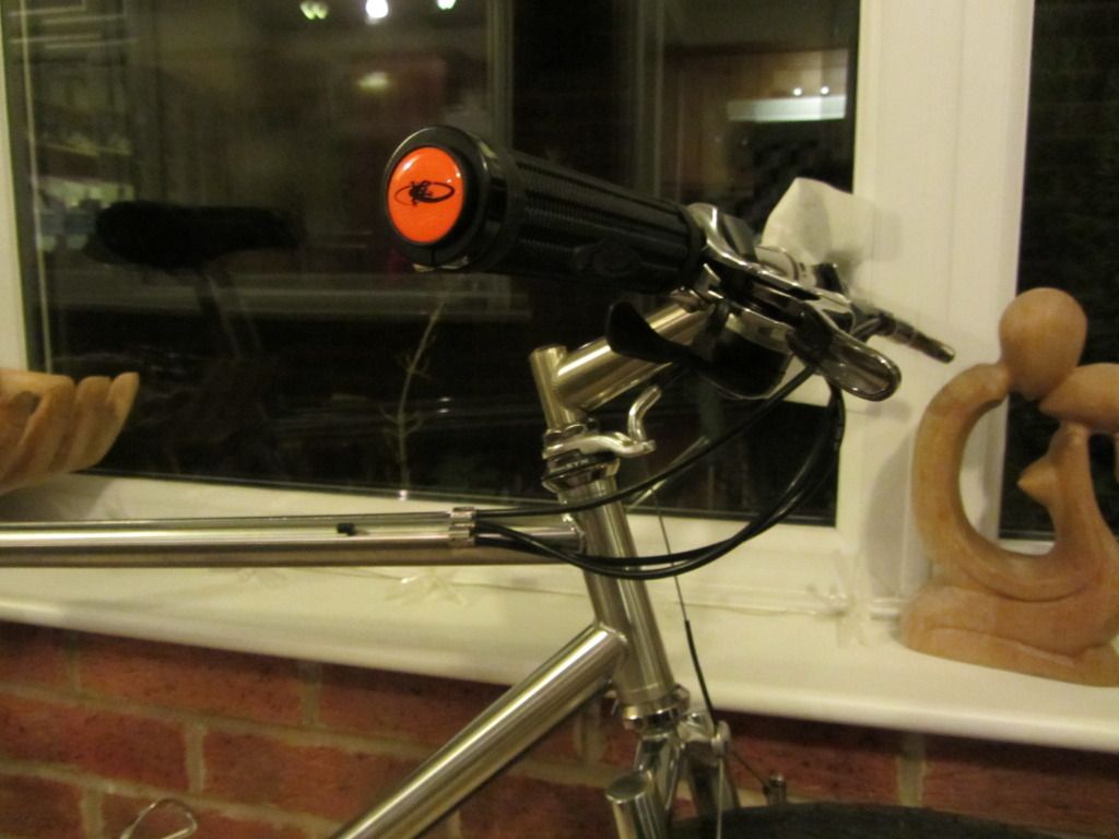

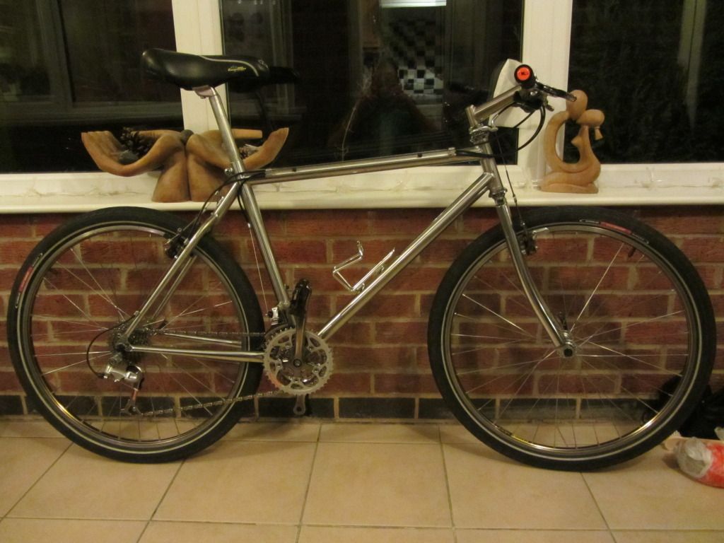

Hi again all, well its finally as finished as its going to get for now, till I get a pass to ride it that is! (Long Story!). Everything is as it was really, except for new grips and a few cables, just cleaned all the bits up and stripped the frame which has polished up really nice. I have new decals but don't want to stick them on till I know whether i'm going to powdercoat or not, depending on how the frame takes being raw and polished a lot. Thanks for all your help guys, its running beautifully and looks awesome naked I have to say ;-)

Hi mate, thanks for the compliment, it does look awesome at the mo. The very small rust spots polished off really well.

By the way, you did a grand job on the bike, looks lovely.
