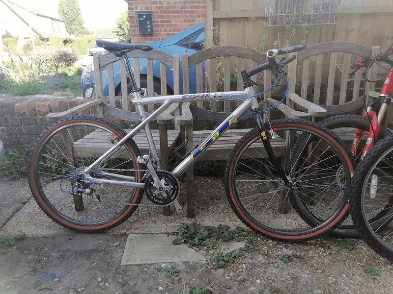

Downtube decal looks original to me.
XTR parts are later. The STI are M910 I think as are the hubs.
Either a frame upwards build or parts upgraded to XTR in its life as we all did.
It makes no difference as they are the same which it is. If you want to decal it a LE and have it XTR it’s still correct in my view but it didn’t start a LE I’d say.

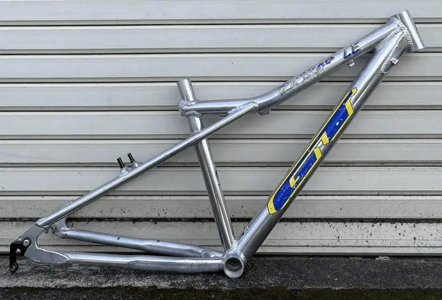

Is this a Zaskar? It's MiA according to seller
Stickers says 96..
..as does serial number

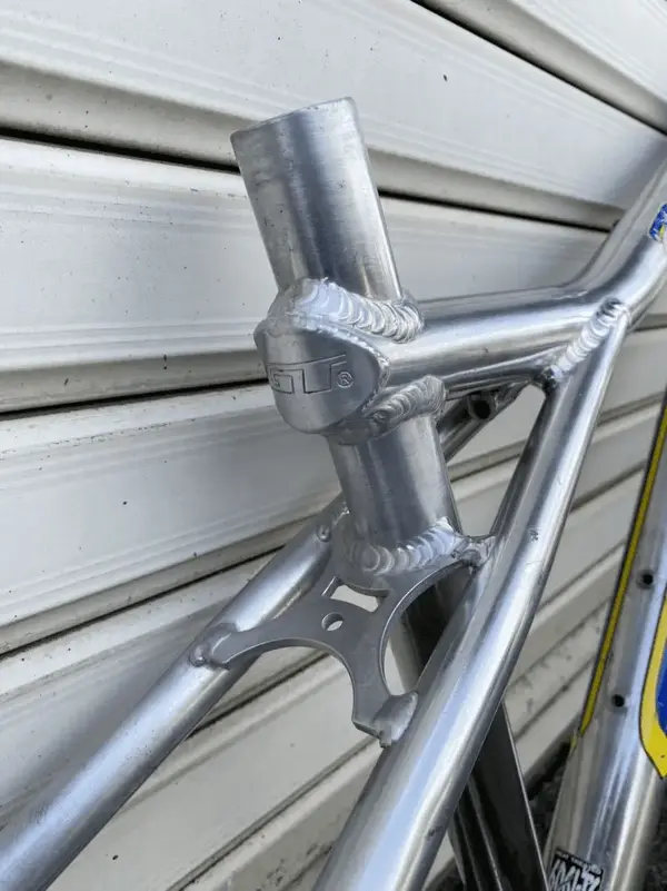

Curved cap?

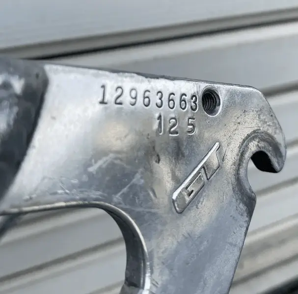

..and you can just about make out^ 6061.. but what's going on with the top tube?..
It's a tiny 14.5" frame.. where the smaller frames this shape?
Stickers says 96..
Curved cap?
Wasn’t there a name for them something like GT Biodynamica frame?
Does that marking not suggest 12.5” frame which was the very smallest they did in 1996 from the Tech shop range and in the kids Zaskar range. The ones in this photo from my catalogue look like flat end caps though.
So the small funny looking one is a Zaskar, this similar discussion took place on here years ago
Generally the Zaskar had a flat end cap but the 91 Avalanche in 7075 also had a flat end cap
