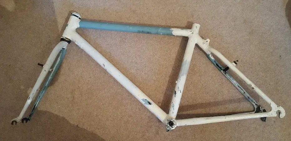

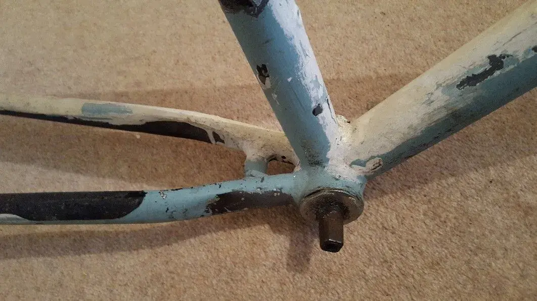

Oh Frame of Mystery, what art thou?

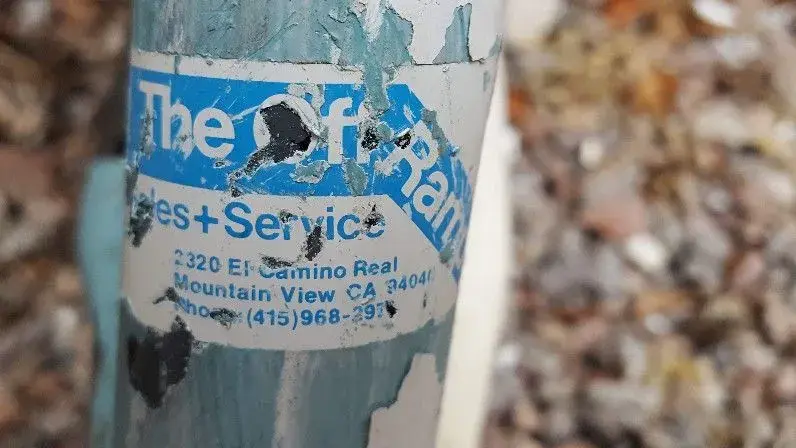

I've just noticed what looked like a sticker under the paint on the seat tube, so I scraped the paint off...
Which leads to this bike shop (maybe purchased from there or serviced there?)...
https://www.offrampbikes.com
Now I'm assuming this frame is early/mid-90's based on:

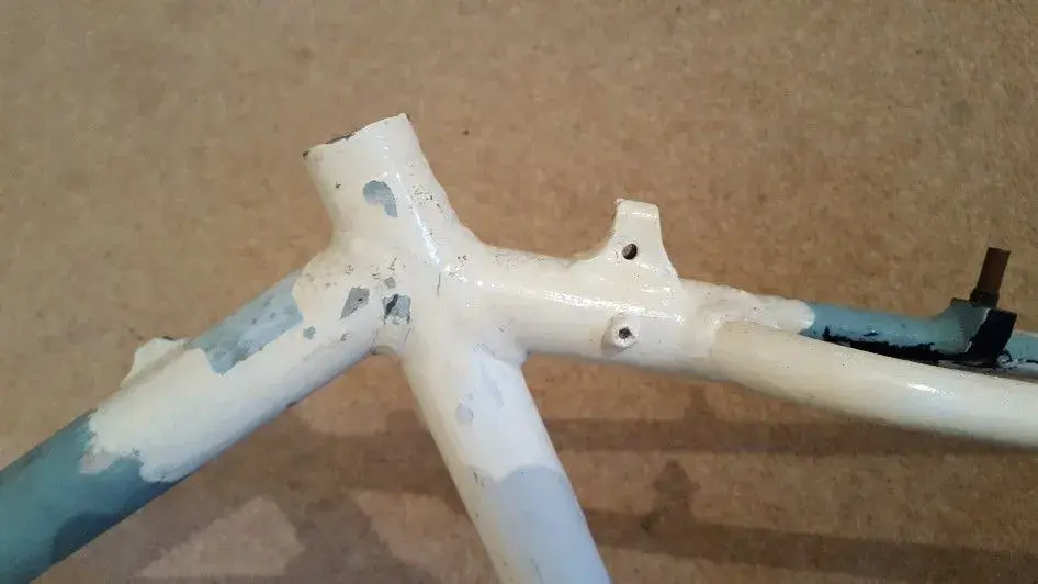

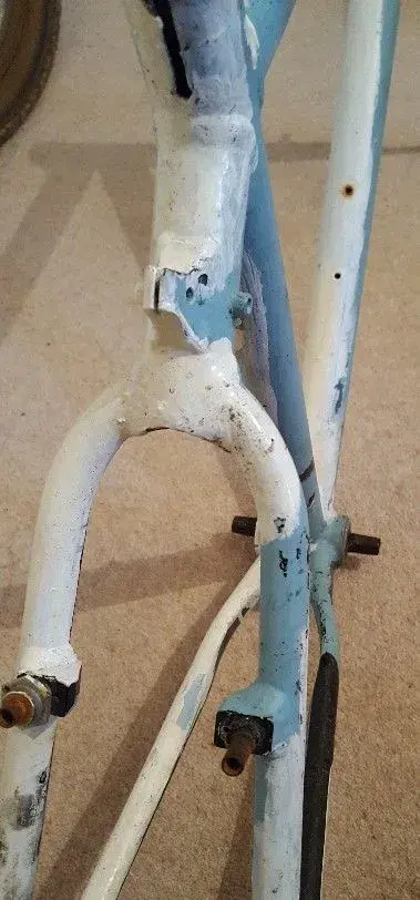

1. Cantilever brake cable stops/routing
2. Cable stops at top of down tube.

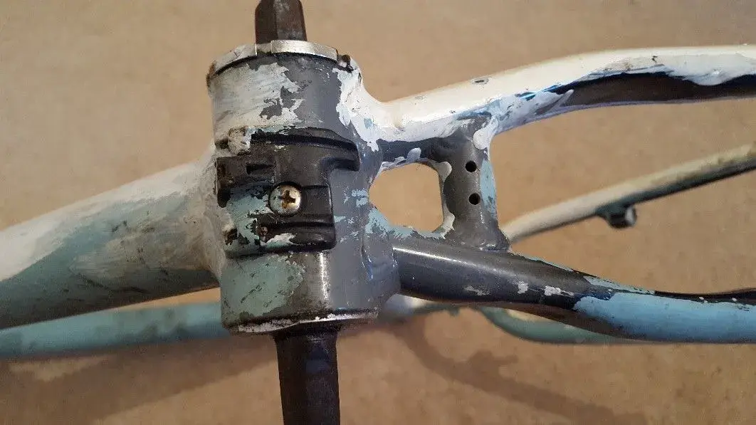

3. Cup & cone Bottom bracket
4. Threaded Headset.
Some of the above are still found on modern BSO's though.

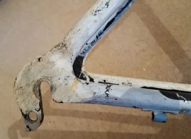

The lack of a replaceable mech hanger makes me think its either an old/early aluminium frame, or just a low-end frame.
The forks I think are made of steel.
There's some grey paint in the BB area which I think is original, and it looks like there's a fade to black for the rear triangle.
Intriguing....

What's the best way of removing the paint that's been added to the frame without also removing the original paint underneath?
Re: Re:
I'd give nail polish remover a go. Stick some on a rag and wipe.
