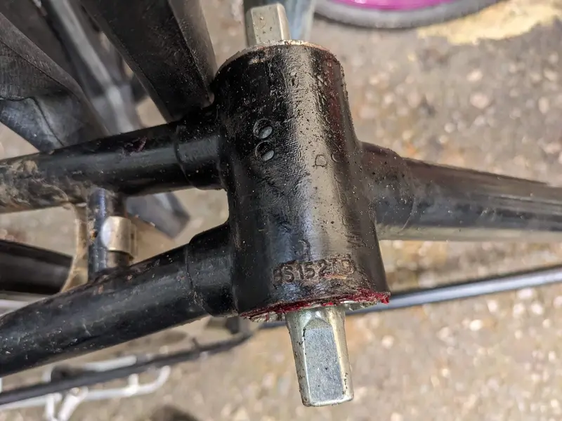

Thank you all for the helpful replies, it is much appreciated. I have posted a slightly better picture of the frame number, but it's still quite obscure. I read it as: WD9001633. What do others see? Any advice on how to interpret those letters and numbers would be gratefully received as I am struggling to make any sense of the explanations I've seen on other websites.

Regarding the frame number...
W = Worksop (I'll come back to that as the frame was made in Nottingham)
D = March
9 = 1979 or 1989. In this case 1989
The rest of the numbers are just the serial.
Back to the W. This stands for Worksop and normally means that it was made at the Carlton factory there. However the Carlton factory had closed by 1989 so the W prefix was "nicked" by Raleigh Nottingham and used to mark the better Raleigh frames made in Nottingham. Normally Raleigh Nottingham frames were prefixed N
