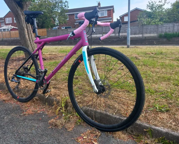

Feels rude not to post a picture of my somewhat molested (consensual) Average Lance.
not a 90's perfect build or anything, more a 2008ish mule that's been treated to a ginger squirt and a good brush. Acquired on here as a frame, seat post, headset and stem and built using spare parts, the forks are glitter Marmite (no one likes them), the drive train is a converted FSA something laced to a 8 speed cassette thats seen better days and a chain that's nearly done with a 2000 ish LX derailleur (front ring came from a very nice squirrel admirer). even the brakes are from another bike that had been upgraded. Wheels are relaced deep section lead rims with a no name sealed front hub and a shimano something on the rear.
