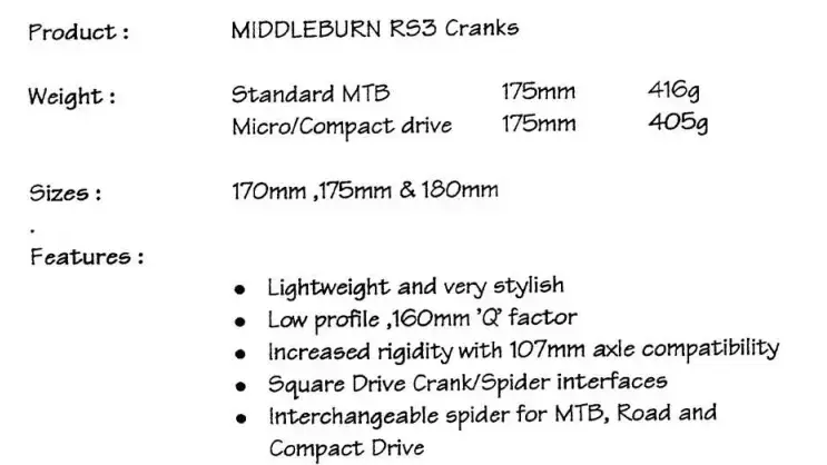

I feel your pain. Going through the same thing with my Middleburn RS-3s on a Trek 990. But have discovered they need a 122, however the chainline doesn't seem right so I now need to faff with chainring spacers... 😭
RS-1s and 2s used a BB that long, 3s were low profile and want a 107-110mm BB. :)
RS3 are super low profile cranks, like M900 XTR.
They are 107mm cranks.
Are you sure they are RS3?

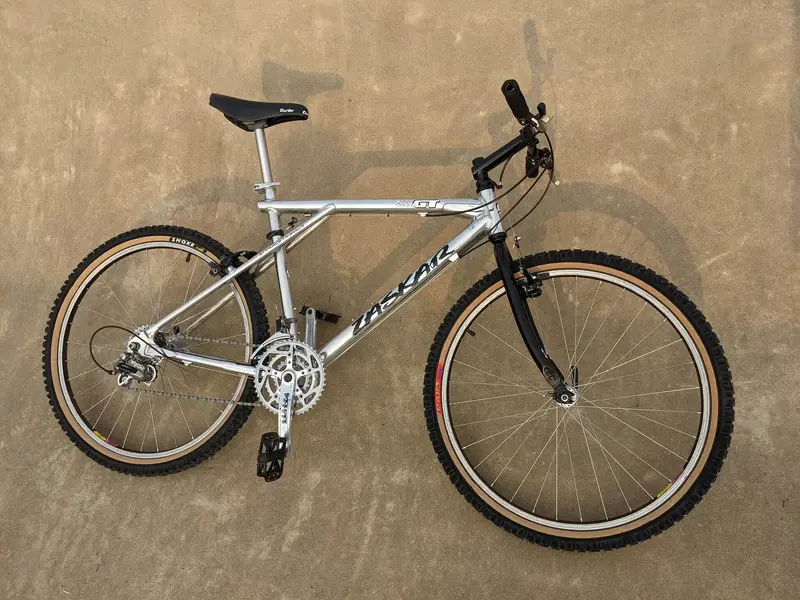

Ah okay thanks, sorry for spamming the thread with my issues, but it's these cranks. I realise I have them mounted on my Zaskar, but they've since been taken off and replaced with an XC Pro crank which used a wildly different BB length. I've long since sold the BB these were mounted with so can't recall it's size. I'm think somewhere around 118/120mm?
107 for them, they're Turbine LP's
(of a super low profile design)
Your XC Pro will probably be 122.5, a normal profile design.
Unless they are XC Pro MicroDrive, which have a low profile design and are normally 115mm.
73mm shell can alter it a bit for superlowprofile if the BB cannot recess the flangy bits you see on some of the cranks.
