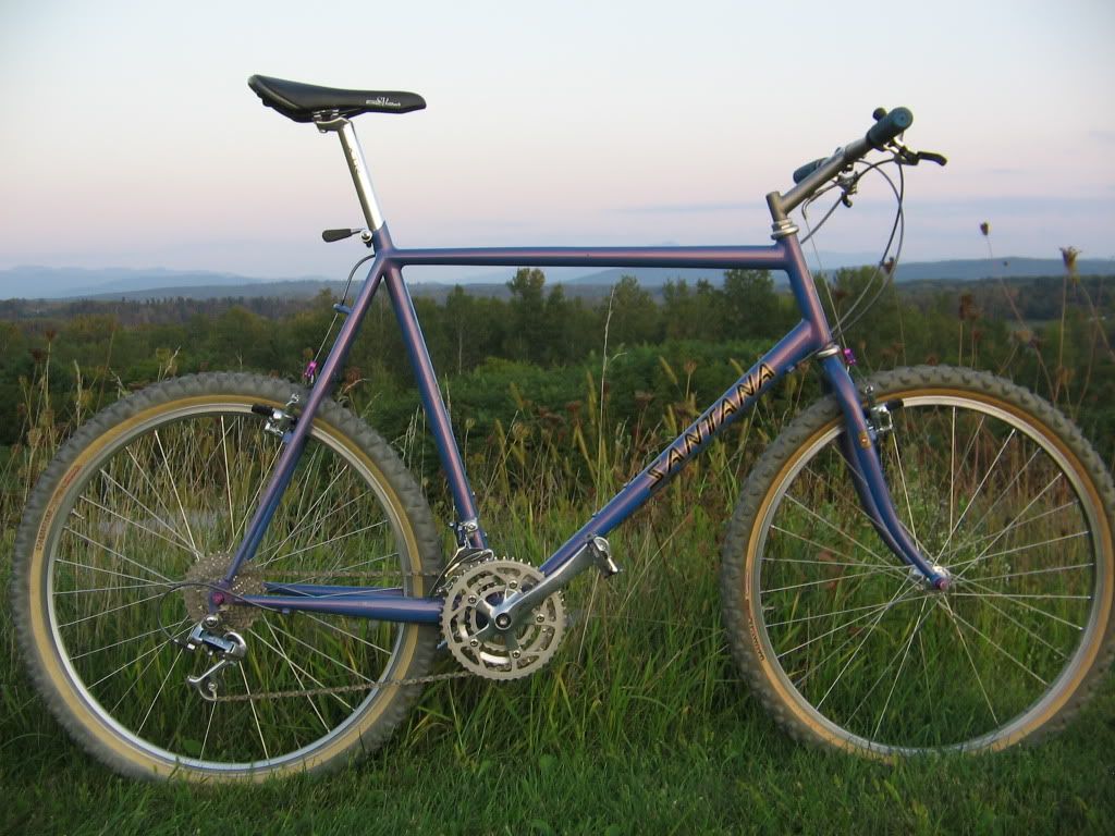

For reference (they are not too common, even over here), here is my Santana:
