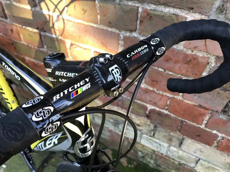

And it’s finished, well the “Father” build is at least.
Originally weighing in at 20lb 8oz or 9.29kg, she’s now an exact 17lb or 7.66kg
So a 1630g loss has exceeded my expectations & to be honest it really wouldn’t take much to get it down to 7kg, with the saddle, old school pedals and fork all a bit on the heavy side.
Saying that it would obviously be more beneficial for me to lose a little more!
Here’s some photos, I’ll do a spec sheet this evening.

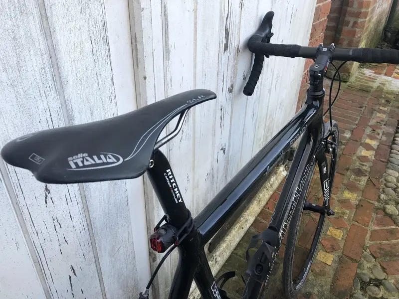

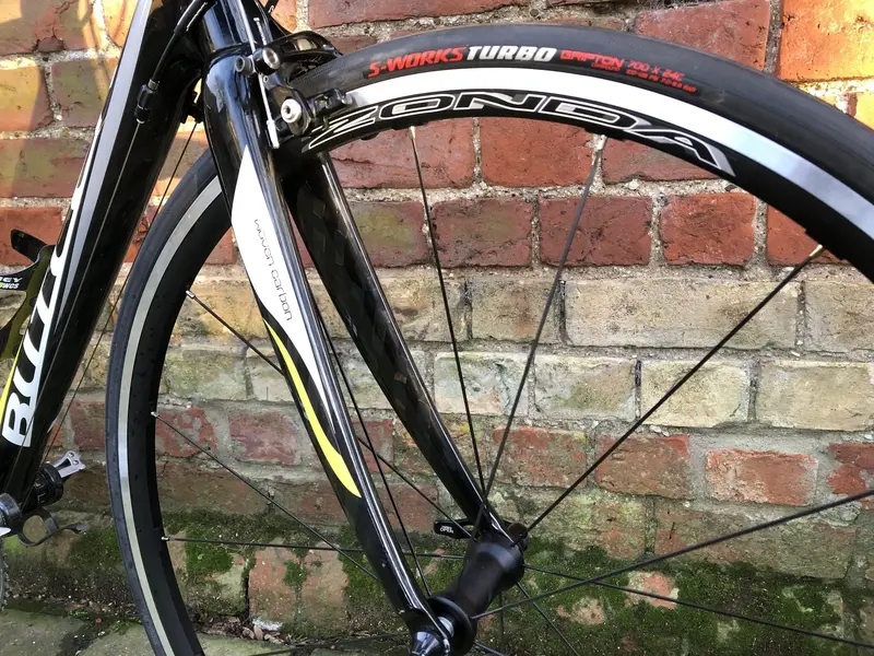

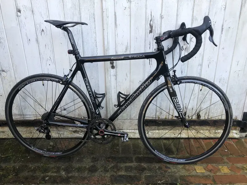

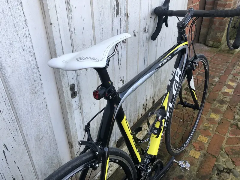

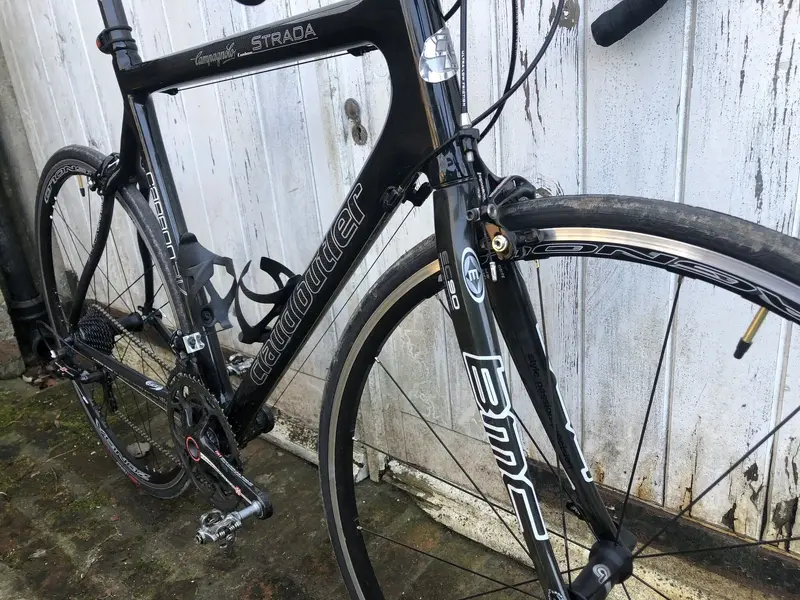

809618AF-C693-466E-8797-AF58F5E35C6B.jpeg B91E60E0-6FF2-46AD-8D82-10C7A75737B9.jpeg 43F1C1B1-83E4-416D-AD39-BD8229D28300.jpeg F56BD1B7-DEB1-4FCD-8C4C-3A781988F3EA.jpeg 7E0ADDFA-9F51-487B-A6AA-AC385D07CF7E.jpeg 55960B22-8DB6-4C70-81D8-366E25D677C9.jpeg 17A25DDE-B70A-4872-8F54-DED8B0724370.jpeg FF5F8546-A9B2-46D7-948F-088C13ACD9FE.jpeg
Spec sheet
Frame: Falcon Claud Butler 12k 22" 1260g
Fork: Falcon Claud Butler 12k/Ali 577g
Headset: FSA-2 1-1/8" 100g
Stem: Ritchey WCS Carbon 124g
Handlebar: Ritchey WCS Carbon 223g
Bar Tape: Cinelli Cork 61g
Brifters: Campagnolo Super Record 11 348g
Brake Calipers: Campagnolo Super Record 11 284g
Brake Pads: Campagnolo Super Record 11 ---
Brake Cables: Campagnolo 30g
Front Derailleur: Campagnolo Super Record 11 71g
Rear Derailleur: Campagnolo Super Record 11 157g
Derailleur Cables: Campagnolo 40g
Cassette: Campagnolo Super Record 11 179g
Chain: Campagnolo R11 225g
Cranks: Campagnolo Super Record 11 635g
Chainrings: Campagnolo Super Record 11 ----
Bottom Bracket: Campagnolo Super Record 11 45g
Pedals: Campagnolo 412g
Rims: Campagnolo Zonda 1540g
Hubs: Campagnolo Zonda ----
Hub Skewers: Campagnolo ----
Nipples: Alluminium ----
Spokes: Blade ----
Tyres: S-Works Turbo 468g
Tubes: Conti Race 28 198g
Saddle: Ritchey Pro 219g
Seatpost: Ritchey WCS Carbon 160g
Seatpost Binder: Claud Butler 27g
Bottle Cage: Ritchey WCS Carbon x2 67g
Weight: 7.66Kg
Nice shows how much a decent groupset reduces weight!

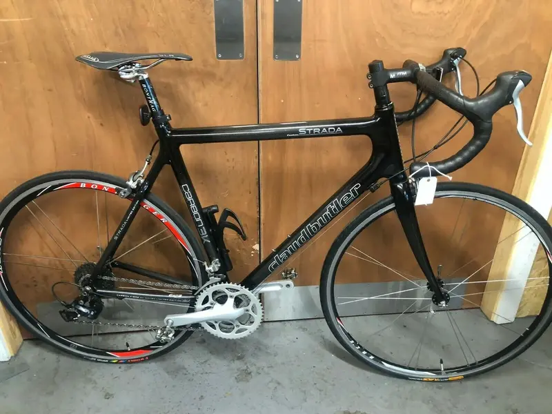

Now then, the 22" Torino was all well and good, but I have to admit as some have already suggested that it's probably to small. after 20 miles im feeling a bit bunched up & although I tried having the saddle all the way back my knees didn't like it...
Then I noticed that the charity bike people at Street Bikes, Kirklees West Yorkshire ('udersfield tha knows) had an older Strada from 2005 that looked a bit leggy, a quick email confirmed its the larger 23" job so I popped over on Monday to have a sit on it.
Pretty much everything on it had been changed including the forks, the only parts being original were the ITM stem & bars.
Anyway, a cash deal was done, everyone's happy.
New plan;
23" 2005 3K Strada for me
22" 2012 12K Torino for the boy @JimBobBurt
Spare 22" 2009 12K Strada will get built up to be a more complete frame set then pushed on.

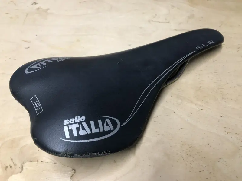

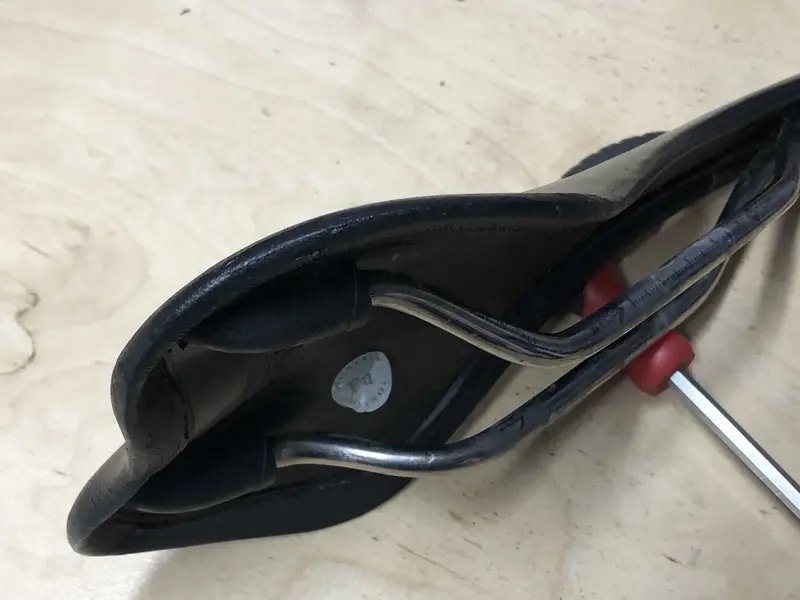

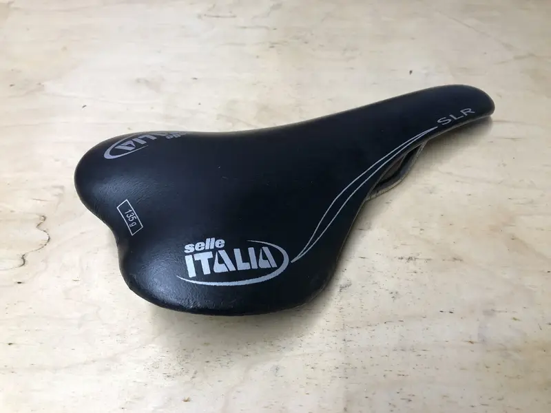

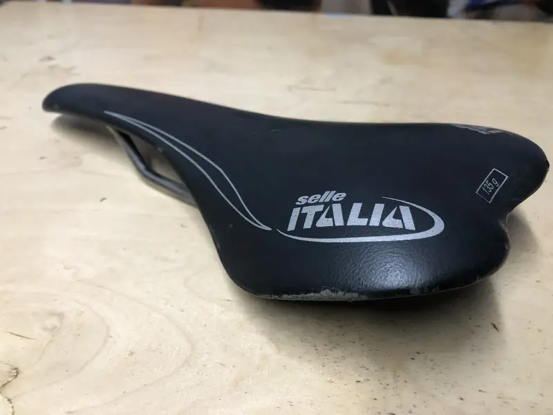

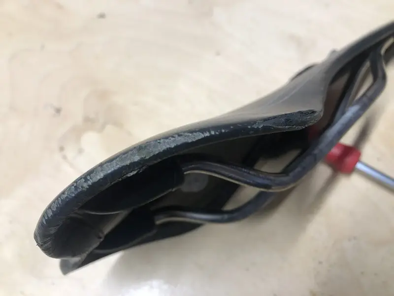

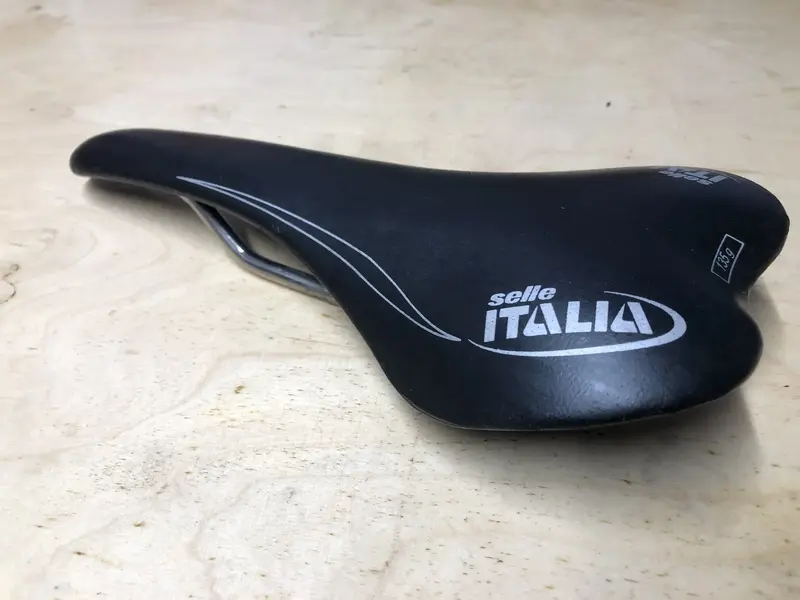

A nice little extra with this new larger frame was a Selle Italia SLR carbon with titanium tubular rails, from 2006 & weighing in at 140g (135g stated) it of course needed a little Peachyfication and I think certainly worth it (there’s a NIB on the Bay at £155)
Here’s the expected before & afters;
304D55C0-F3DC-4C04-8A9B-9FADE89D7E7C.jpeg A235EF39-138F-4E5C-967C-4369990A5570.jpeg D0ABD460-3DC0-4276-8A45-49462263FFCA.jpeg E3544B1F-F48C-4ACE-8CF3-F8F32AC558B3.jpeg 145540E2-E672-4DD4-AAD3-D5262866B6AC.jpeg 6030D9C5-BB49-480D-AAFF-B49C37BD7835.jpeg

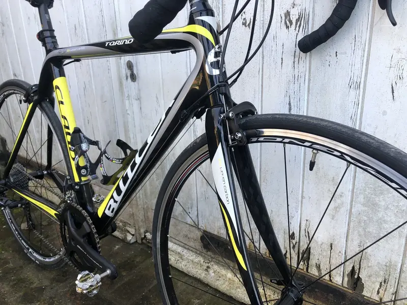

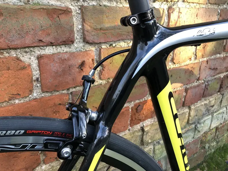

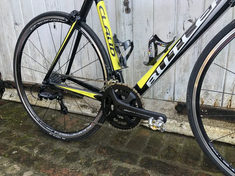

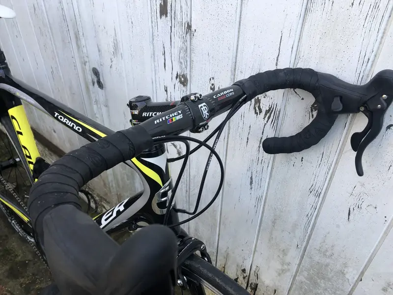

Now then, seeing as this thread has a proper home I guess I’d better post an update!
These bikes kept me quite busy during February, initially with a bit of selling off of parts to fund some of the quality.
The initial plan was to upgrade the taller 2005 Strada for me and tweak the 2012 Torino for the lad.
This was duly done producing a very tidy sub 7kg Strada for me and an 8kg Torino for the lad.
Lots of tweaking, renovation & repair took place which I would normally have photoed and posted but I wanted wait to see where the thread would live.
Anyway, after completing them we had a cracking test ride (about 30miles) with the club and all went very well.
So, what to do with the leftover junk and 2010 Strada 3k frame? Well I thought an all weather hack might be good idea. So with a mix of components from the other two and a sprinkling of spares I now have a 9kg puddle splasher!

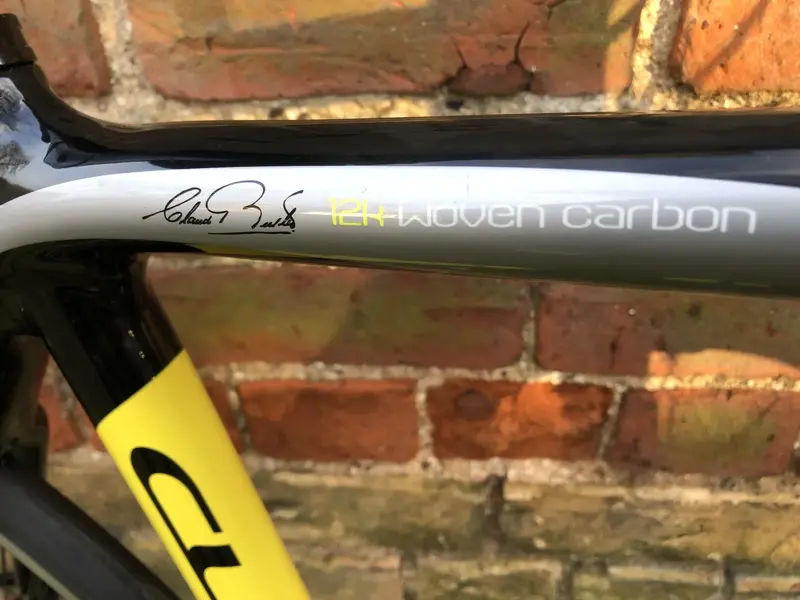

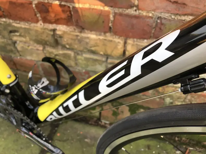

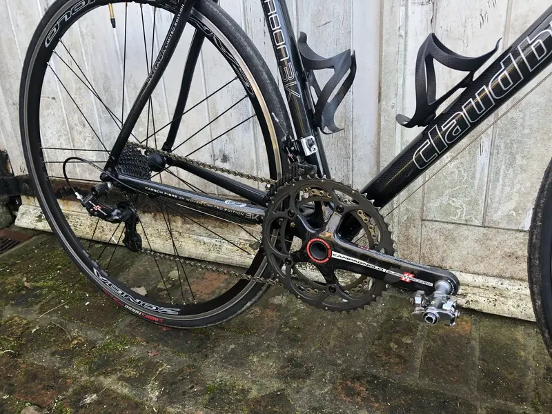

The 2005 6.5kg Strada
1223A002-4C40-4D99-90B0-E4ED7FA75641.jpeg 878ED75A-1B83-4A29-BEA0-024C6784BEF7.jpeg C24A0B7D-4F9E-4883-9720-DF7DE36D3764.jpeg 71048FBA-0D78-4F17-B1C3-8ED57FD93887.jpeg 18394640-0A67-4544-87D4-7A7433C97F24.jpeg
