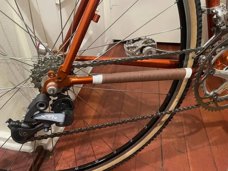

I'm actually building something with a mix of 7700 and M952 right now.
The 7700 FD is a double.
As someone else said, the cassettes are really similar construction (ti, drillium vibes) but massively different ratios, as road vs mountain.
I'm running the 7700 barcon shifters (with the Paul mounts) with an M952 RD and a 7700 FD, plus the 7700 crankset.
Here it is with the DA cassette:
Please ignore they very bad chainstay wrap! I promise I had a good reason for trying it with the white electrical tape on the ends.
It's not there anymore!
I've actually already switched out the DA cassette for a modern Shimano 9-speed mountain version, so I can run a more useable ratio.
I am planning to switch out the crankset for a mountain triple next (which might have to be some other group entirely due to clearance and space issues on this very weird bike), and when I do will most likely run the M950 front mech alongside it.
Was thinking of running just a mountain two up front with the DA front mech, but I'm not sure things work that way!
This whole bike is one giant experiment/PITA for me.
I hate it. But it looks so good it just keeps me coming back for more heartbreak!
