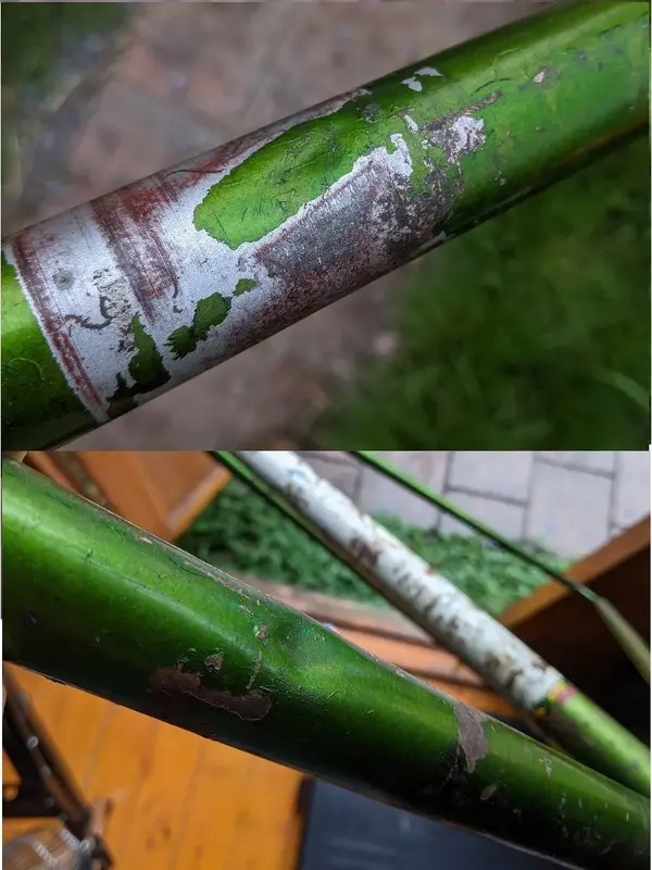

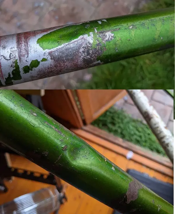

Tried rolling the dent out. Got to the point where I'm clamping so hard, I'm afraid I'll bend the frame while rotating it.
The dent is still there but is much improved compared to the original.
Did @Mickeyspinn say you can use shims to get rid of the dent completely?
Some before & after snaps.
Rizla papers and a bit of grease 👍
Get your calipers out find the high spots on the tube..... most likely immediately after the beginning of in to the dent if you catch my drift!?
Marker pen your high spots and lay one or two wrapped around the rest of tube. Go gentle....keep checking measuring etc.👍
You'll get a bit more out I reckon ...don't think your going to lose it all I'm afraid didn't realise it was that deep!
Looks close to being less "dangerous" ish now...good job 👍
Not quite following.
High spots - yes, still there.
Previously I would just lube up the tube and rotate the clamp around it while tightening.
Am I only placing the fag papers near the high spots, or around the whole tube?
It's basically the high spots that need the most push...so lay the papers on them...nothing covering the dent!
Try it like that....check and measure um and ah...
Then add papers between high the spots aswell around it's circumference.....again not covering the dent 👍 stop check measure etc.....slowly catchy monkey.....only one or two papers at a time.
