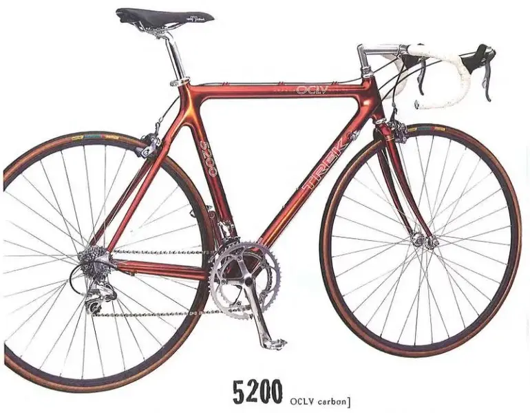

Late last year my son purchased a 1995 Trek 5200 Carbon road bike with my blessing. I'm more of a lugged steel guy but my son was smitten with the nice carbon lines and amazing red/copper paint, he also likes vintage rigs. Full 600 tricolor components are nice too.
I don't have a pic of the actual bike handy, here is a screen shot of the same bike from the 95' catalogue:
My question is with the very slim and beautiful carbon fork. I realize Trek was aiming to appease the roadie crowd of the day and ensure it looked the same as a steel fork but it is very, very flexible.
I'm talking under hard front braking, the fore/aft movement can be pretty unnerving when I have taken it out for test rides.
At this point I'm mostly concerned with possible failure (29 year old carbon). I will probably push him to swap for a period steel fork but he plans to get out this weekend and start putting some miles in. He will be a pretty tame rider though. No crazy downhills I'm sure.
Does anyone know the reputation of this fork? Prone to failure or just very flexible?
Thanks for any helpful feedback 👍
Treks of that era could suffer from corrosion between the aluminium inserts at the steerer and drop outs and the carbon fibre. Usually the paint around this area would bubble up and flake off. My 2007 Trek Madone has been my dedicated turbo/Zwift bike for a number of years for this reason. Although everything still feels solid enough it doesn't fill you with confidence!
Thanks so much for all of the helpful feedback! I will definitely give it a more detailed inspection for riding expected to take place soon.
I'll also start the hunt for a steel or modern version not only to be safe but it will provide a much better riding experience in the long run 👍

My own view, you just have to be very sensible - no reason to be paranoid, but must respect the fact nothing is eternal, and some materials and productions technics aged better than others. Consider rider weight too in your decision process.
Finally, I've had uber lightweight Carbon, Ti, Cro-Mo forks, and very pencil thin vintage steel forks - they are all designed to have some give and flex for good reason. Personally think a lot is to do with if the bike was thrashed to near death before by racing, accidents, and bad treatment.
