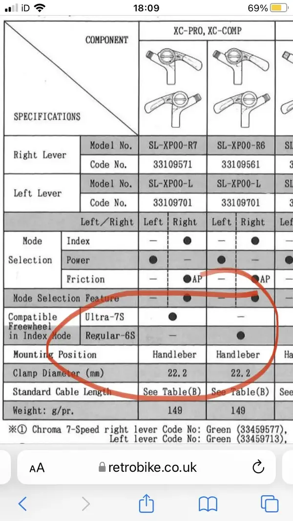

Does anyone know the difference in the pull/spacing of these Suntour Mechs.
I ask because old Suntour Pro-CX and CX-DT had a
215 Shifter setup for the X-1/Chroma/ XC 90x0 XCE range (and Superbe Pro/Edge/Blaze)
to the
225 Shifter for the XC PR/Comp/Ld/XCD range (and SL/GPX Radius)
(Talking pre-1992 era)
Detailed catalogues are in the archive, since I scanned a lot and put them there and I don't remember any specific details.
e.g. https://www.retrobike.co.uk/gallery...ur+Archive/Catalogues/SunTour+Catalogue+1991/
Suntour could have nailed Shimano in this period if it’s indexed gears weren’t so damned fernickety and constantly changing, the product was definitely better (IMHO).
I think the problem will rest with Suntour’s ‘Narrow/Ultra’ or ‘normal’ indexing, there were certainly at least two versions each of 6 and 7 speed indexing for a few years.
Certainly Micro-Drive spacing was different to non-MD spacing, and there was a precursor to that in the XC9000 era too.
If you have a 7 speed standard and 7 speed MD cassette you could probably figure out the spacing and work from there.
I could,...
If anyone hasn't noticed and didn't realise Pro-CX and CX-DT are SRAM GripShift 215 and 225 both are the Suntour 7 speed versions
So it's not the speed and it is pre 1992 so not MicroDrive.
I'll see what I can dig up
Not sure I have a Normal cassette in 7 speed, probably on MD.
Some good thoughts above.
One quick if I remember the model list, what changed in Edge between 1990 model (cx-dt 215 targets this) and 1991 Edge (cx-dt 225 targets this) the only one listed with a split date.
