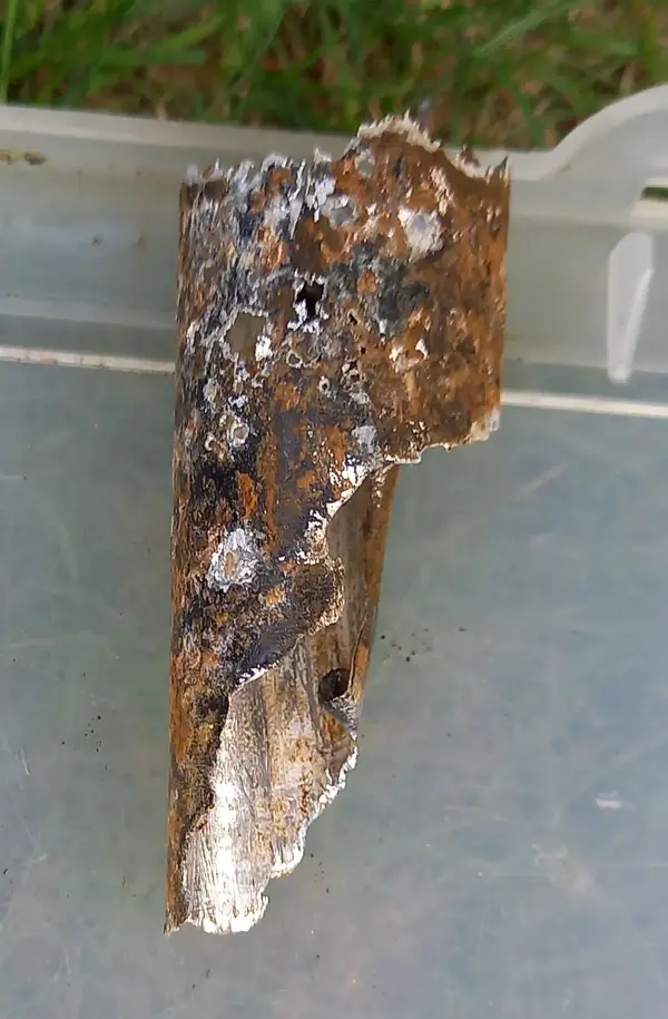

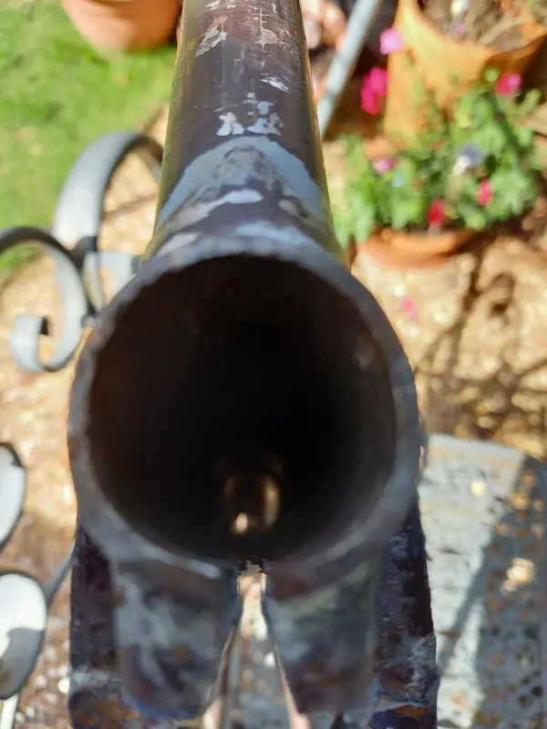

My wife tells me I can be a stubborn bugger so I went back to it. The Caustic had thinned the post enough that I was able I hammer and twist it out with brute force and ignorance. There's still 6cm of post left down there but it's very thin and there's plenty of room for another post so I might just leave it, or would you recommend trying to get it all out?
Good stuff 👍
Feels good winning don't it!?
If it were me....and what's left in there is thin I'd go at it with another hit of acid.
Last thing you want is to build a lovely bike to keep....and a few years down the line after corrosion gets going again it splits the seat tube!
