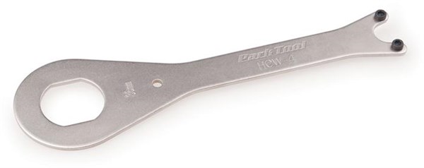

HOWEVER! The BB may be a git to get off, the right tools will help:
the pins are replaceable:
http://www.sheldonbrown.com/tooltips/bbcups.html

Thanks, brilliant. I was looking at something very similar on the same site. The adjustable pivot version, about 1/3 of the price.
