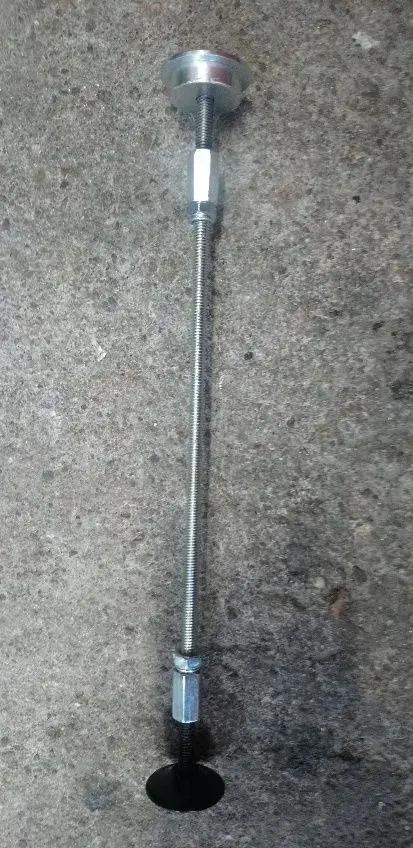

Is the steerer open at the bottom, under the fork crown? If it is then just clamp it all down with a long time rod, washers, and nuts, tighten the stem, and remove the clamp. Will make on the road adjustments difficult, but at least you'll be able to ride it was
Re: Re:
It's an idea. I do have a lovely anodised top cap and bolt for it though :cry:
Re: Re:
Yeah something like below, I had to make this as I couldn't get a star nut down the steerer. Threaded rod, couplers, nyloc nuts, and a top cap each end.
After tensioning the aheadset and tightening the stem bolts I left it in place. Otherwise you need a bung or similar for a stem topcap.
Cost about £5 all in.

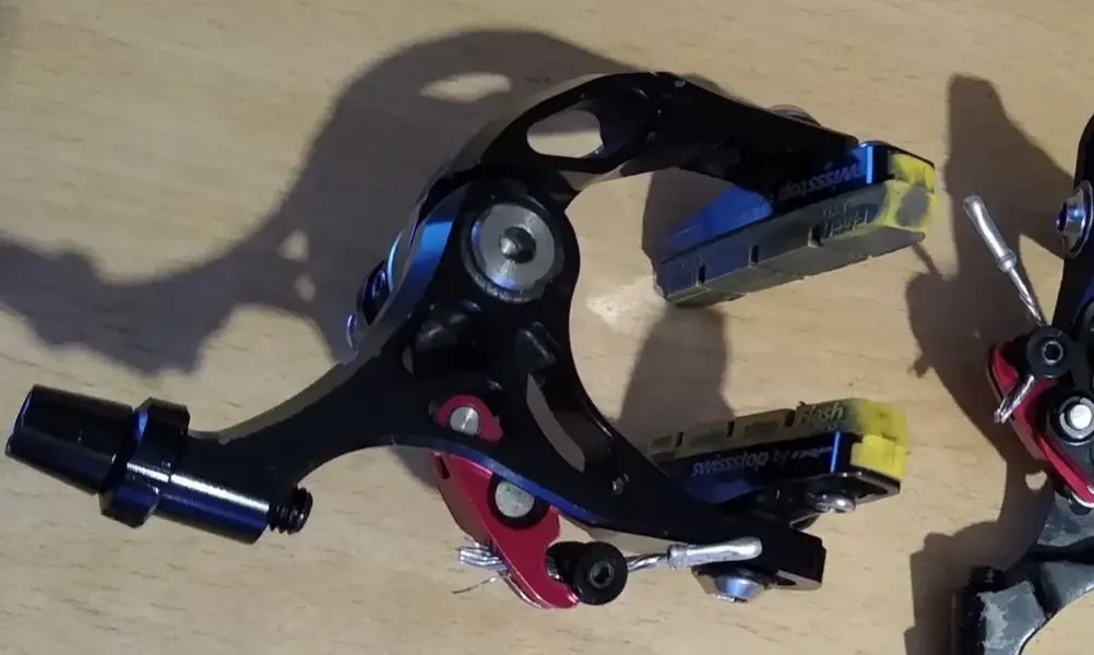

Been waiting for some lightweight brake calipers this week. Turned up yesterday, so I'll be fitting them along with different pads later today I hope.
As I didn't have anything but normal Ultegra, I fancied something different. So I found theses ones.
IMG_20191011_181410274 by Mike Murray, on Flickr
Campag Record skeleton calipers, which look a bit different, but to be honest, are barely lighter than the Ultegras! :LOL:
So I found these Token Accura ones.
IMG_20191011_181527739 by Mike Murray, on Flickr
So with brakes to do, bar tape and bottle cage. Hope to get it finished tonight. Oh and paint chips to do as well. :roll:
