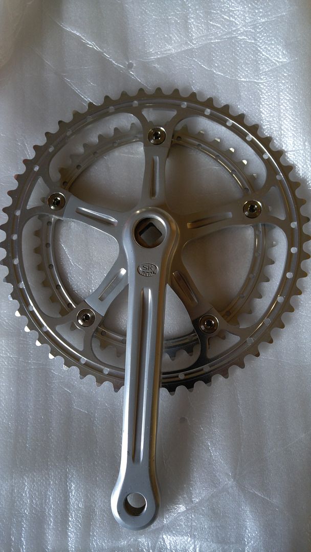

Hi Shaun,
Just a thought. Is it possible that you have a 70-SS-120 Campagnolo spindle installed in the Sakae cups? Because that condition would look like that. As far as I know the Sakae RY-BBS bottom bracket kept the same part number through the mid 80's at least, and I believe but I'm not positive :shock: that all Royal cups were thin cups, I could easily be wrong.
I also am a fan of Japanese parts, Sakae Royal is one of my favorites, I like the black accents on your LA5 chainset. Here is a gratuitous photo of my LA5.
Best Wishes: Mike

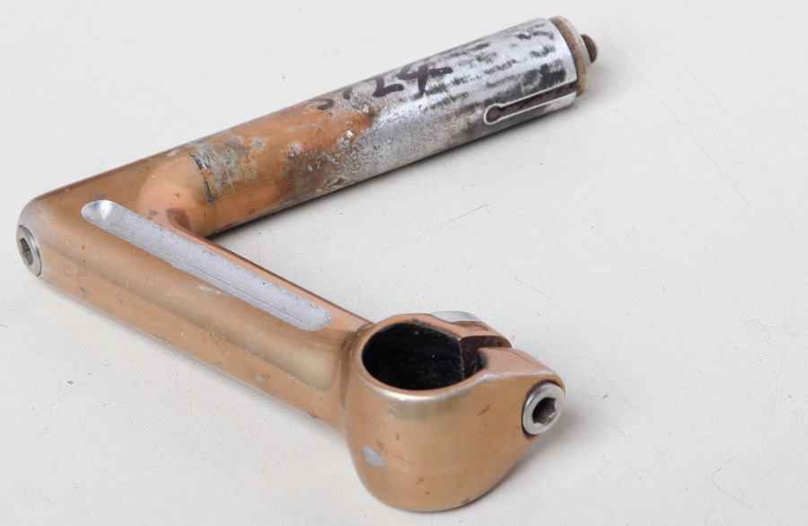

ooooh! That looks nice :) The SR and Shimano had a depth of anodising that gave them a classy milky appearance.... Those rings are to die for:) I'll have a hunt for my SR Super Extra Light stem and seat post :)
The axle in the Falcon above could be anything, working in a bike shop in the 70's meant I had a smorgasbord of kit to use :) If you look at my avatar I'm running a black one of the below stems.......which I bought from the rep.

Hi shaun, The rings are Cambio Rino from the 80's, probably the coolest parts of their entire line of kit. The best part of the 70's and earlier was the amazing variety of parts that made up a race bike, and all the small manufacturers that built bike parts. Things were changing fast, and the japanese were leading with their high end stuff, I just wish more of it was made as it's getting hard to come by. I am a fan of your time trial bikes, very cool bikes your building.
: Mike
