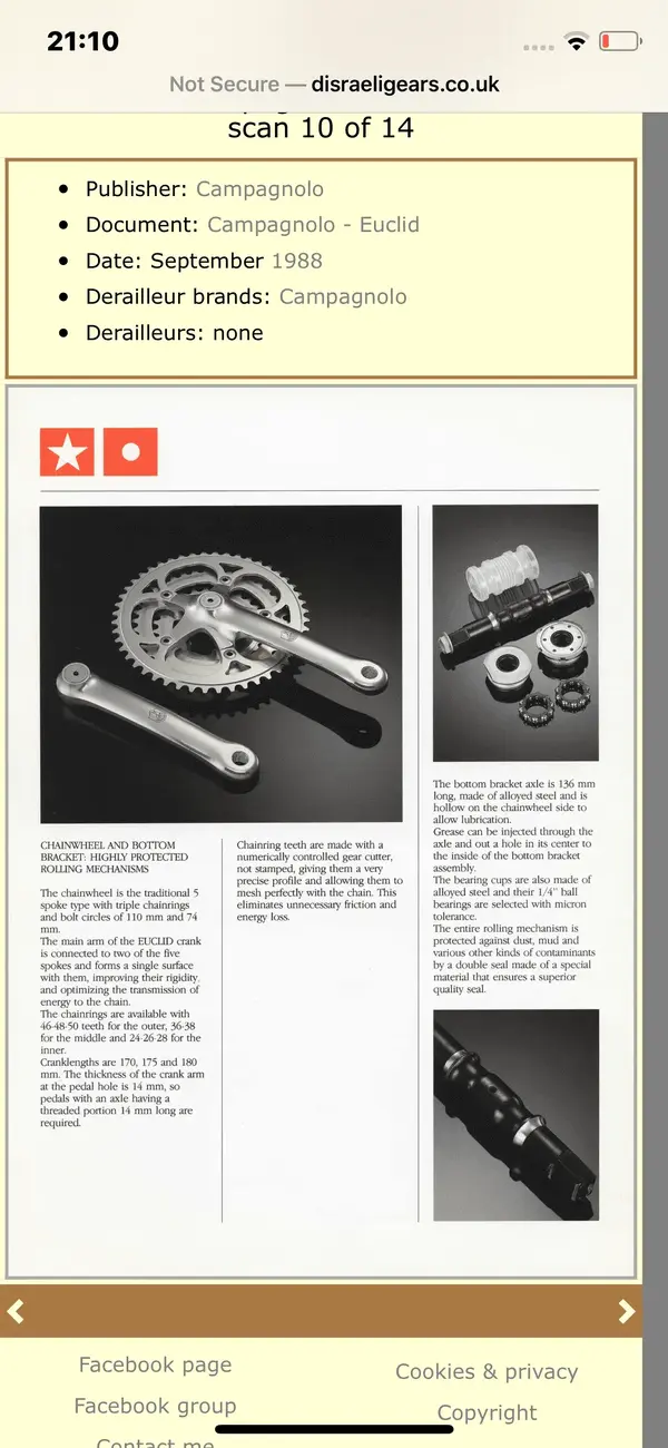

The plot thickens as I found this :
And the Cranks are the same bar the finish - but BB axle length is 137mm
If anyone can solve this mystery please let me know
Extra info
Any help appreciated as I was /an about to pull the trigger on a campag contax 124mm but seeing this and looking at the frame chain line clearance etc - comparing the Shimano with ISO tapers etc - I’m thinking the 124mm may be too short and result in Chainring against chain stay
But 136 seems a bit long.

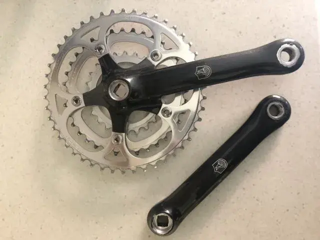

Here are my cranks - same as the satin finished ones
Above

Here is an invaluable source :
http://www.disraeligears.co.uk/Site/Cam ... an_10.html

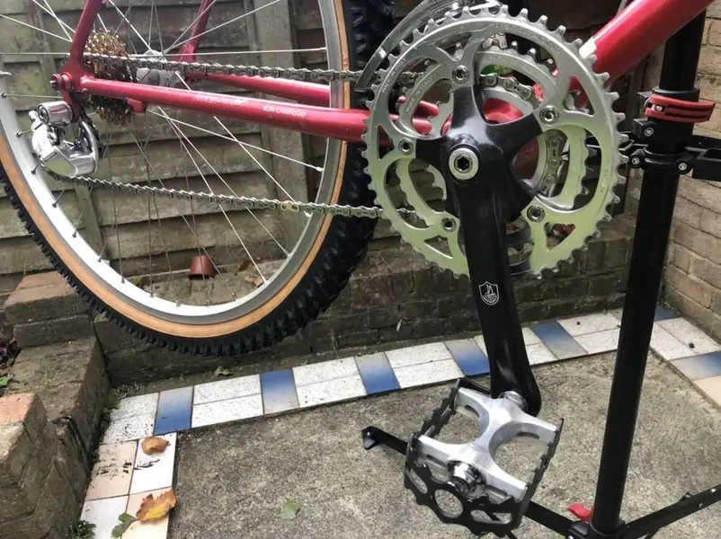

Here are some pics (bike just needs the cables sorted and the Record OR cantis set up)
