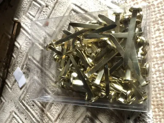

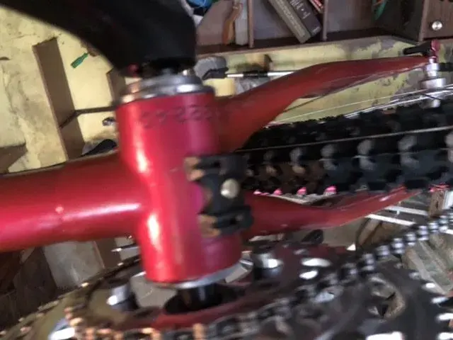

Well I solved the problem
It turned out to be so simple yet as with all simple things - sometimes you over complicate.
The jack bolt didn’t work as the thing was too big to fit inside - and as I bought some gorilla superglue I had a sudden epiphany - why not use a brass split clip? I don’t usually go for brasses but I went for this one - and it worked perfectly and cost me £1 from Wilkinson.
Trimmed the clip - put in - and it was secured -
