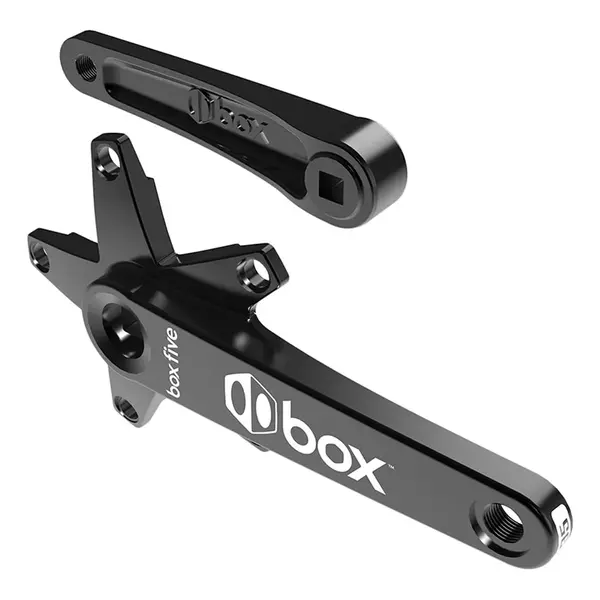

In regards to the cranks, I think it boils down to the fact that I've wanted profile cranks for years. I like the look of them, I like the fact that they are not aluminium and I suppose it is the special factor at the end of the day. This build was meant to be a bit different, using mx bars, bmx stems as I like the look of the stems and I enjoy the thin tubes and stiffness of mx bars. I suppose I just wanted to play around with as many different components as possible, and I also like the easily adjustable chainlines of bmx cranks and their sprockets look fantastic.
DH specific cranks aren't really a topic I'm familiar with, any recommendations?
Look into "cinch" or direct-mount type cranks. They use a large-spline interface to attach a single chainring to the right crank arm, and because the connection is done around the axle they allow use of rings with less than 30 teeth should you need that (30t is the bare minimum for the older style if cranks that use 4 bolts 104mm apart). Added benefit in your case would be the lack of any bolts on the chainring, so you'll get that BMX- like looks.

Bottom bracket to be used is your choice, as long as it's a name brand and compatible with the cranks I doubt you'll be disappointed in its fitment or performance.

I have decided that I will probably put on a set of Box Five square taper cranksies...
