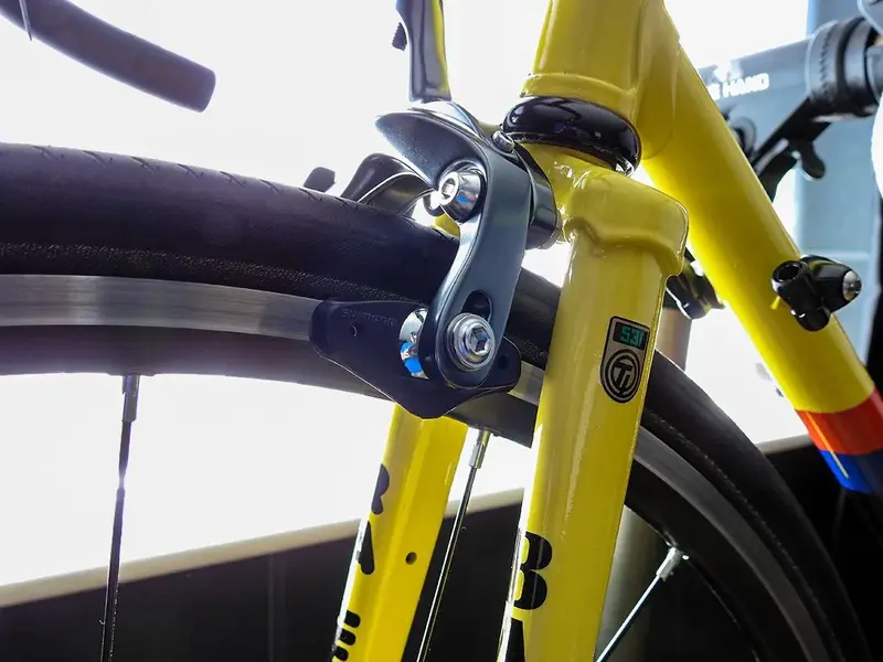

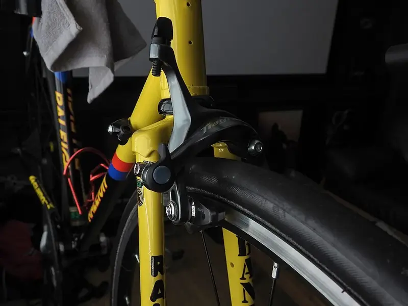

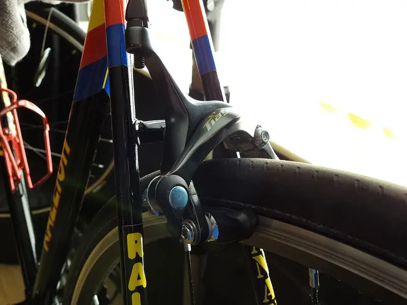

Just wanted to add some more details and pics for anyone out there contemplating on restoring a banana and like me were clueless where to begin.
I read that not all brakes will work on this frame, some frames needing / not needing long length calipers etc.
In my case with this Banana I can confirm that the Shimano Tiagra duel pivot brake calipers both work fine with a 700c wheelset, at least my wheelset which is a Mavic Aksium shown here.
Just need a couple of those conical washers and a longer bolt for the front caliper and am in business :cool:

The pads on the back look to be significantly too high, they'll be rubbing on the tyres.
Nah it's just because the caliper was loose when I took the pic. I've nipped it up n brought the pads to the rim, they actually needs to go up a few mm to be central on the braking surface so all within adjustment.
