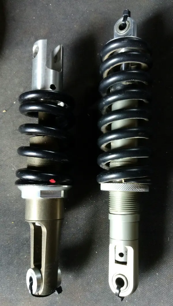

I have no idea what the shock is...it looks AMP, but not much travel, too long eye to eye for a B5, and with a clevis on one end...
All the best,
The shock is too short to be from a B5, only 155mm, not 172mm.
It's got an 18mm spacing kit on one end, for a 6mm bolt
The other end is a clevis, not a normal pivot, 12mm width, 8mm bolt.

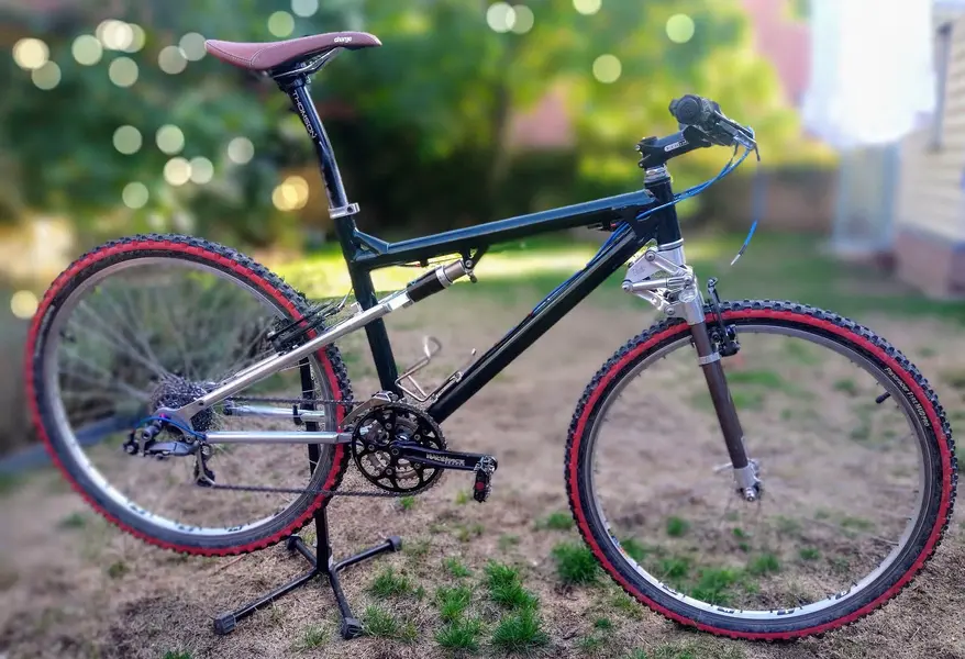

The sliver one is an earlier model. Despite the similarities there was a lot of evolution in the Amp frames, with much more CNC in teh rear triangle in later years.
I'm happy to be wrong on this, but I thing Gerads silver one is a B2 with the black one being a B3 (?)
They're both B3's the way to tell is that the seat stays clamp around the body of the shock on a B3 on the B2 they clamp around the shock end cap, it was an attempt to shorten the stays and stiffen up the rear end.
