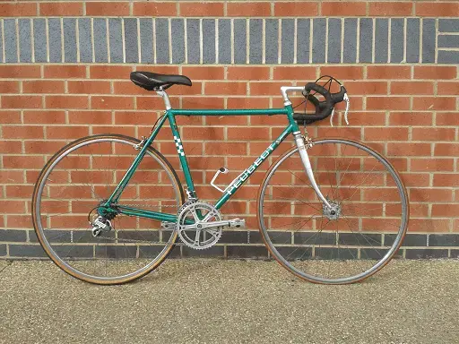

Parts? You want PARTS? I'll give you parts:
Frame = whatever it is but resprayed 531 tubing
Fork = Vitus 979
Stem = Cinelli 1A
Bars = 3TTT Tour de France Due
Brake levers = Mafac
Brake calipers = Galli
Front mech = Shimano 600 Tricolor
Rear mech = Shimano Dura-Ace 7402
Shifters = Simplex (hurrah, originals perhaps)
Cranks = SR
Front wheel = Maillard hub from 1983, prob Mavic rim
Rear wheel = Ambrosio rim, unbranded hub
Block = Regina
Headset = Campag
Seatpost = Campag
Seat = Bontrager

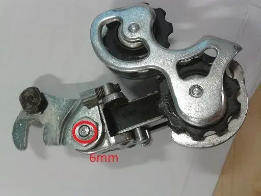

Dropout/hanger (hole 10mm):
Simplex mech I assumed would fit because knew no better (inc bolt 6mm diam if took claw off):

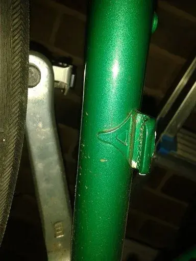

Front mech bracket (I assume after market as NO Pug I've seen has a braze on):
I hope I can find a Huret if it works, sounds ideal.

I may have an answer ??
undo the 6mm bolt. This will reveal a bolt (6mm), a female part that the bolt screws into and the claw. The hex nut showing on your mech is part of the female "nut". Put this female "nut" into the dropout - (it wont thread in) and screw the 6mm bolt into the female part and your mech is in situ. Hold the hex part with a spanner and tighten up the allen key bolt (the 6mm bolt) with an allen key
job done
(assuming (a) you understand my jibberish and (b) I have interpreted the parts correctly
