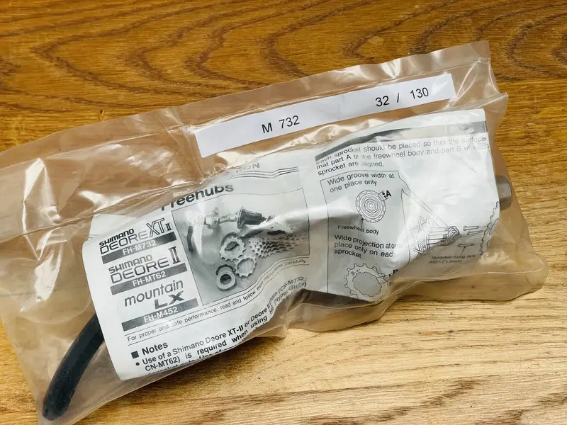

So I've looked at probably 10,000 fhbs in the decades of a busy shop and at a glance, the length of these German ebay numbers make them a 6View attachment 825313
And then the ones in a bag are 7:View attachment 825314
If I pulled them out of the drawer (blindfolded obvs) I would say the top one is 130/6 and the bottom 135/7
... but we've been looking for the unicorn of 130/7, and see a vision in the clear morning light that is hard to deny!
Mine is defo 130/7

Shimano introduced 135mm with the new XT II range in 1989. 126mm was ditched at the same time
The hub bodies are different shapes between m730 and m732. The shoulders are square on m730 and rounded off on m732. Also the grease port is different.
The top pic is m730...bagged m732.
They are not rare.....m732 with 130 spacing 7 speed are all around us. Most people just don't realise as all they read is m732 and assume its 135mm.
These below are all 7sp 130mm m732 hubs......i would give the spare to @boy"O"boy but its earmarked for some wheels sadly. So thats 4 of them, and those are just the ones laying round my house! Unicorn.....donkey......as most want 135mm to fit their frames.
