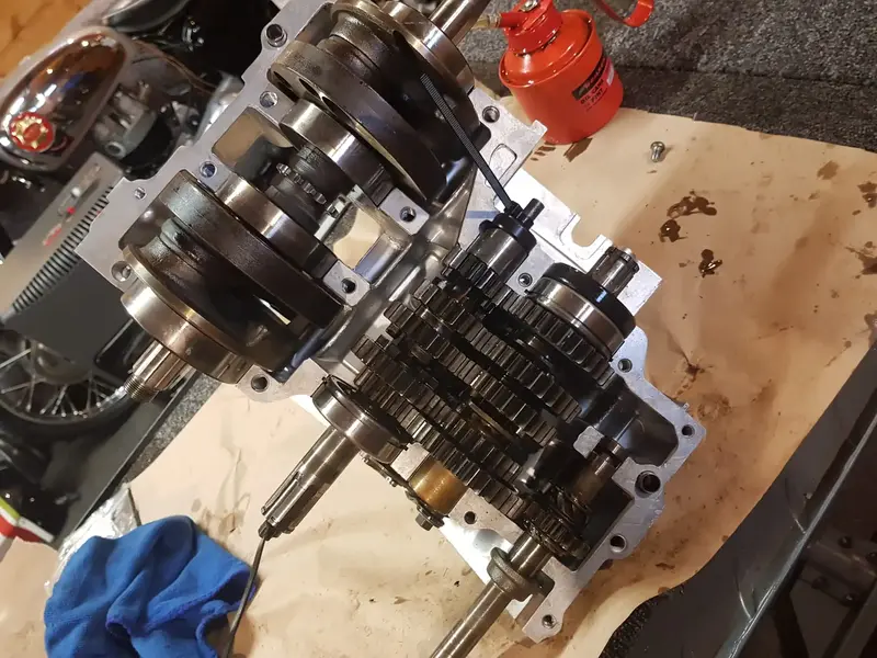

Anyway its far simpler than this.....which was todays problem....moral......put stuff back the way mr Honda wanted it.....not how you think it should be...🤣
Same goes for hubs.....

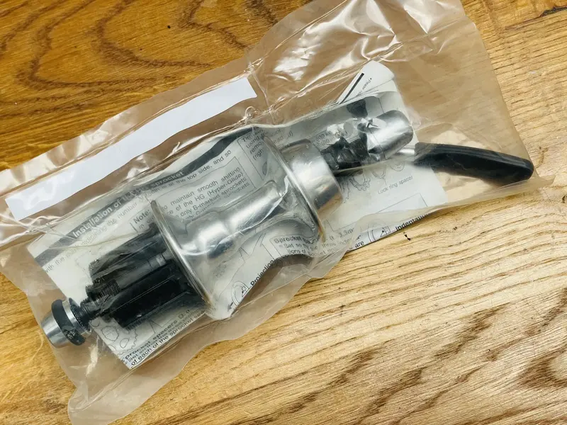

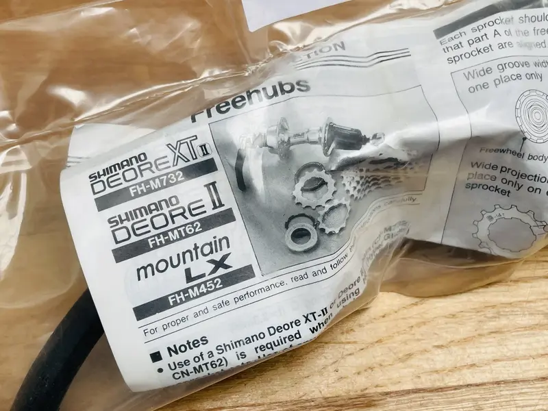

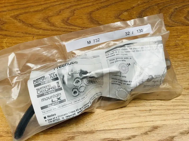

I’m selling some Nos XT hubs, rear is 130 7 speed
