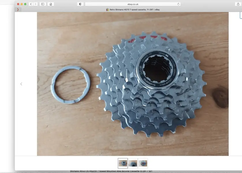

Thanks for replying @FluffyChicken and for the insight 🙌🏻 great to know this will work 🎉 yes that was the next bit i was confused about, i couldn't figure out where this spacer needed to go. Please see attached cassette i just bought. I don't have the original cassette sadly.
Is the spacer you mention the silver washer looking ring on the left in the first image?

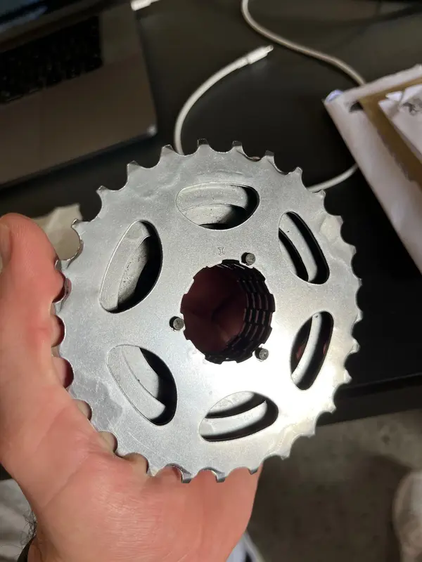

Do you know where the 2x dark grey washer / spacer rings would fit in the middle image?
And it looks like the rivets on the back can be unscrewed with an adjustable spanner maybe.

The dark grey 1mm spacer fits between the two smallest cogs. Essentially insert in the stack until all the spacings are equal. The silver one looks liek a 3mm spacer needed to fit the 7s cassette on an 8/9/10 hub, which has a longer bit for the extra gears.
Incredible thanks @hamster thanks for help with 1mm washers, so your STX hub i'm guessing is 8/9/10? so i have everything i need if i use the 3mm spacer at the back? according to sheldon he also says, i need to buy a Hyperglide C lock ring as well, do you think that's necessary? (sorry for more questions)

If you move to a newer freehub, and it is 8 speed and not 7, then you'll need that 3mm spacer.
If you just wish to fit that 11-28T to you current free hub you need to find another of the thin 1mm funny spacers and put one at the back.

Its really is as simple as @FluffyChicken said in his first utterance! All you need to complete the task is a spacer, put on the freehub first.....then put on the cassette.
Unless you want 8 speed or more, there us little point changing the roughly 30mm 7 speed freehub out for a 35mm longer one for 8 + speed......as you will just need more spacers to mount your cassette.
If you ask in the wanted section, im sure somebody will have a 1mm washer....
The reason there is a problem, which may help you understand the solution, comes from the way the 11 vs the 12 bottom cogs are cut where they interface. 12s goes right onto the freehub splines, but an 11 does not.....it has a rim on it.....hence needing the washer to make up the lost space so you can clamp the stack down.
Also , more "modern" hubs have a slight cut away on the edge of the splines which allows 11 speed to engage further onto the freehub.
