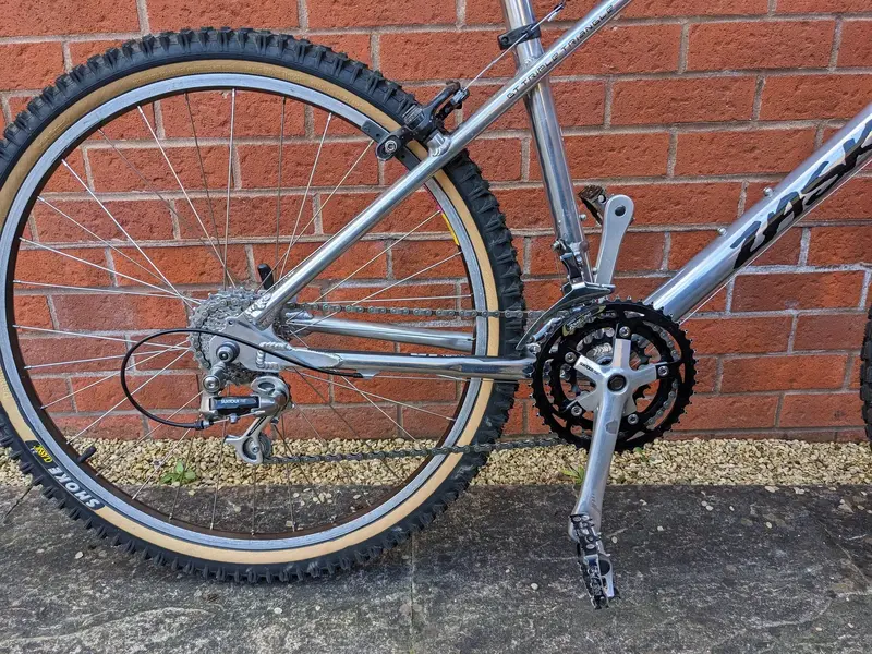

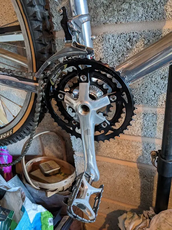

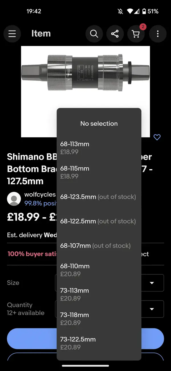

Bit of an update, now have some xc pro pedals. Question is does anyone know what spindle length BB I need to fit an xc pro chainset? The inner ring is catching on the frame as the race face cranks before had a wildly different offset.
In the process of doing an XC pro Zaskar myself (much further to go than you have!), but I believe the spindle length should be 125.5mm or thereabouts for XC pro.
73mm BB shell though, so that may mean it needs to be 130mm? not sure if that’s how it works!
My '91 Zakar had a 68mm BB shell.

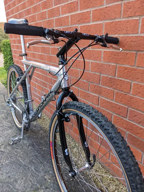

What an amazing transformation!!! 😍😍😍 Love an early Zaskar and the XC Pro looks PRO! Lovely, clean and very business like :cool: 💪

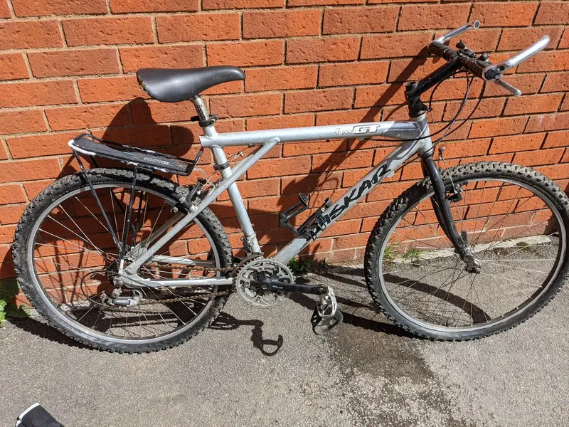

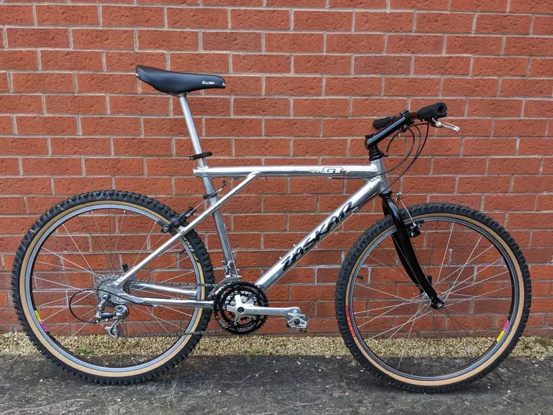

Thought I'd remind you what it looked like on page 1:
