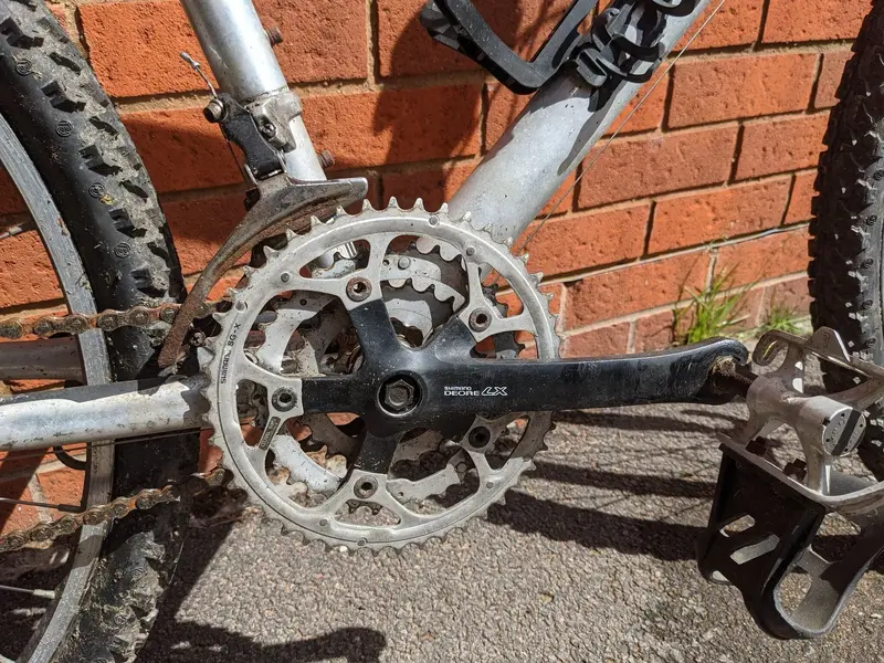

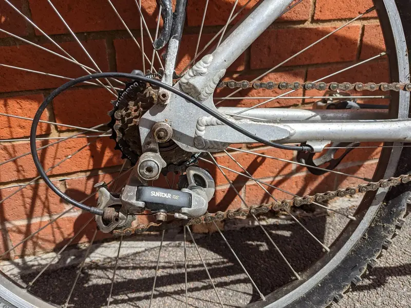

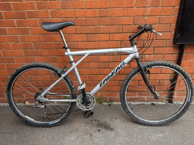

Hi, I've been a lurker in the shadows on here for many years, owned a whole raft of MTB's during that time (1990 onwards) from Muddy Fox, Bigfoot Smokestone, Club Roost (snapped two frames, very bad bikes!), Kona's, Specialized & Santa Cruz. I've never in that time owned a GT though. So I recently put that right by purchasing this from a local auction (I think a couple of you were bidding as well!). It's a very tired looking 18" 1991 Zaskar with 2x4 forks and some Suntour XC Pro. I bought it without viewing (always dangerous I know) but it looks like it'd been stored outside for a long time, most steel elements have succumb to rust.

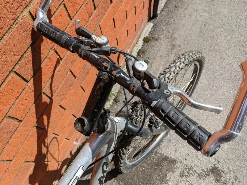

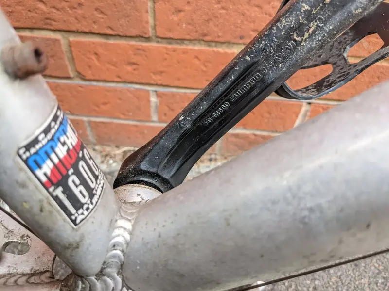

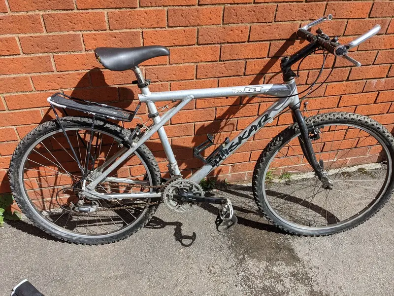

The narrowest cockpit I've ever seen!
Let's get rid of the pannier & get that chain moving, it was like a length of solid steel.

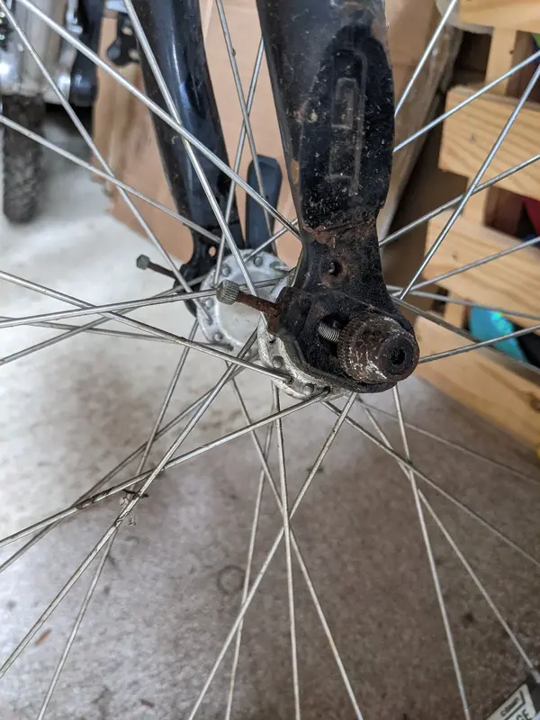

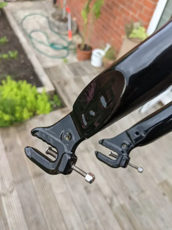

Forks are in a pretty bad way. They are currently away (along with the stem) at a paint shop getting blasted and resprayed gloss black. Hopefully they come back okay. Paintshop didn't seem too fazed by these pictures when I sent them over so hopefully they'll be alright.

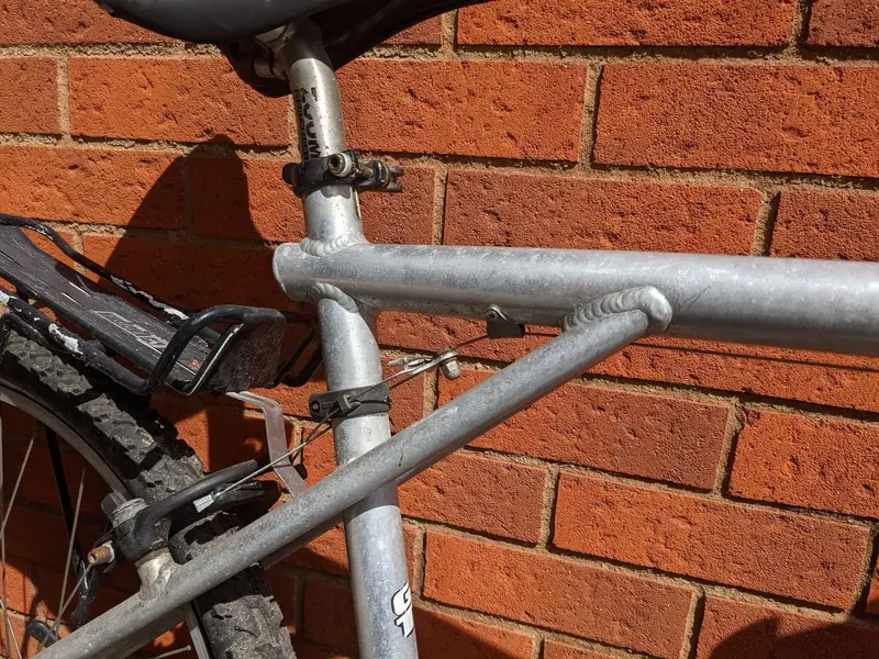

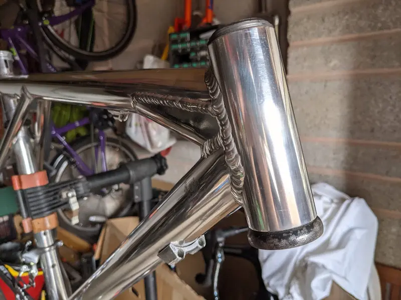

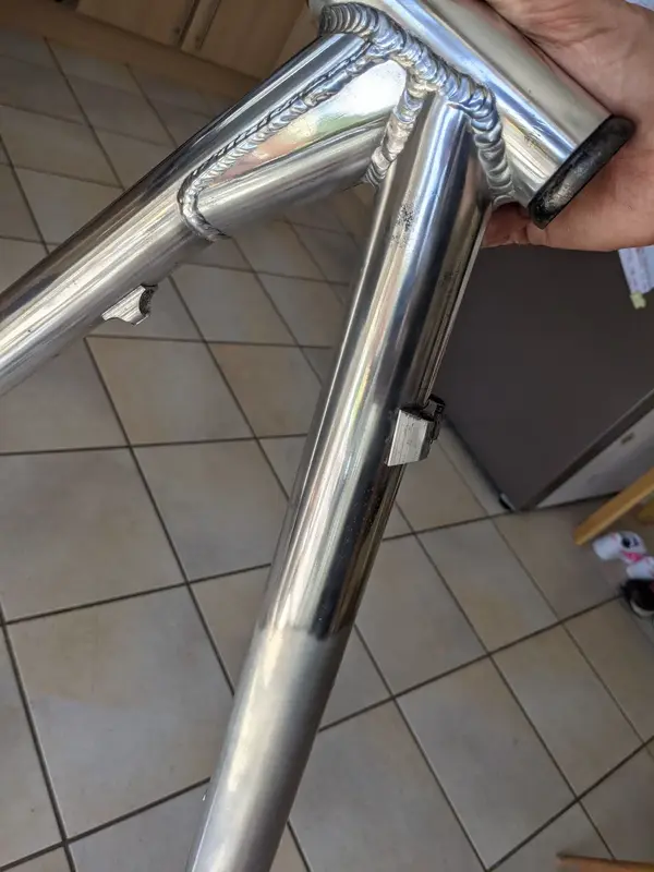

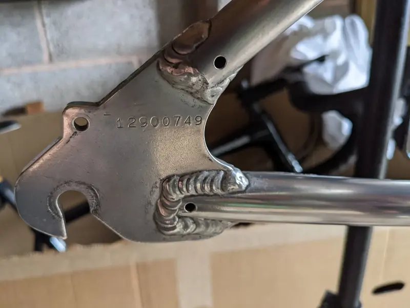

The first job was to strip the frame and get to work with some #0000 grade steel wool and vinegar/water to get rid of the oxidisation..

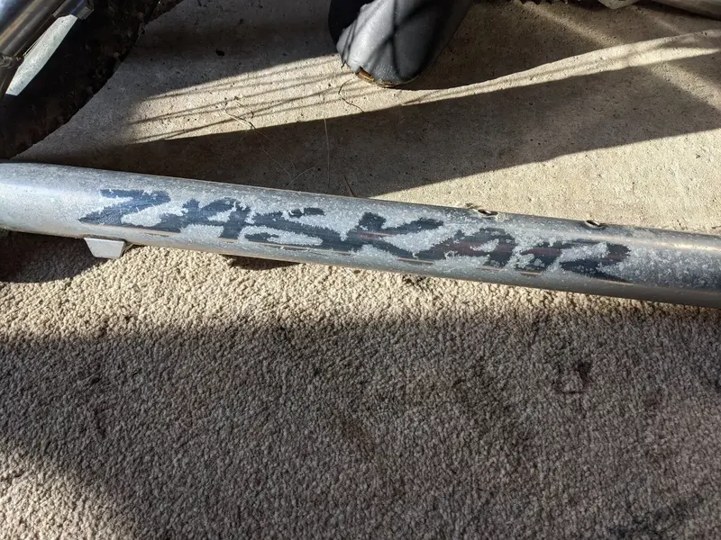

Decal removal..
All the wire wool bit done, now onto the polishing. I was really pleased with how shiny it came up. There are a few blemishes, but I'll accept that given it's condition before..
Headset is being replaced once I get the forks back, shiny shiny.

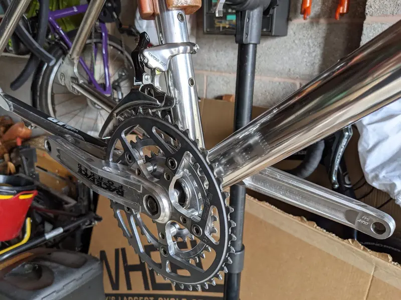

Couldn't resist mounting the cranks (thanks Tom!) and my NOS XC Pro derailleur. May yet go back to XC pro cranks as I have a lot of Suntour kit to go back on. Perhaps these race face look too modern?

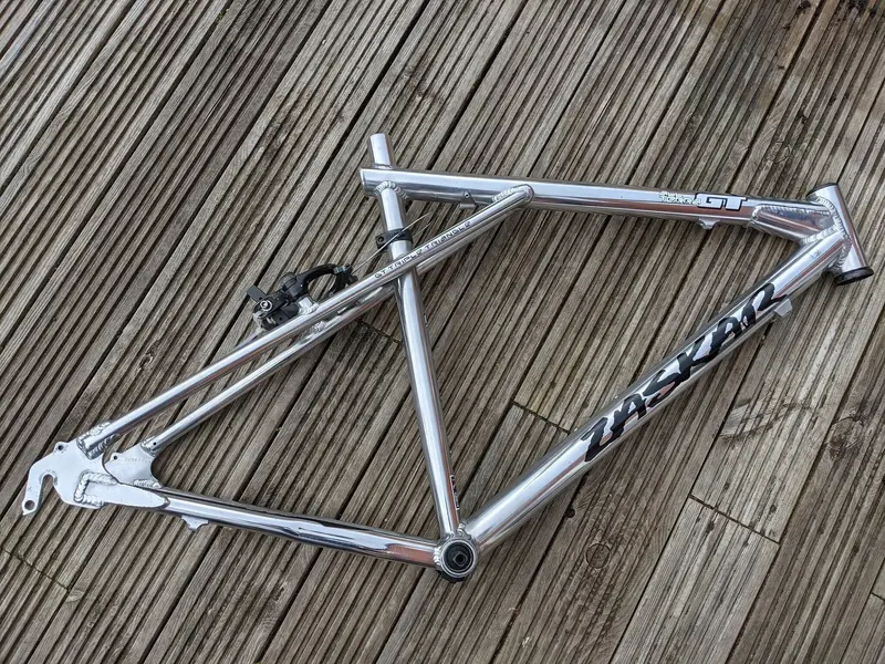

Polishing pretty much complete, it's back from the dead..

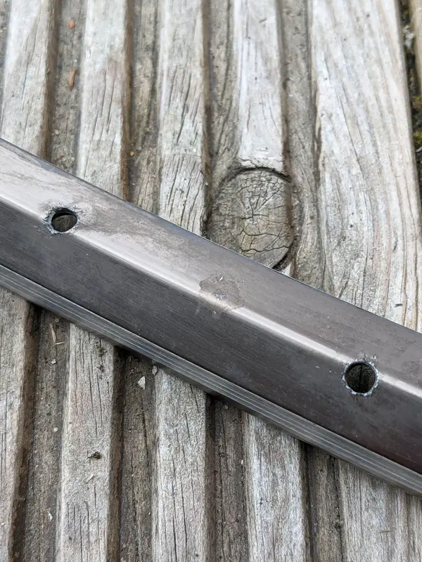

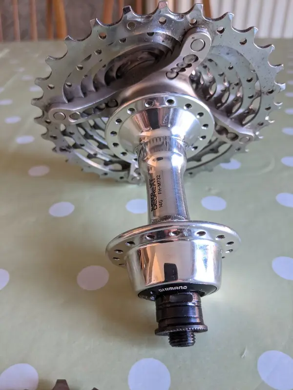

The original hubs were pretty minging, time for some M730 goodness. Rear is rebuilt and smooth as you like (thanks Tootyred). I have an NOS 32h front hub to match (imported from Japan, don't ask how much!) ready to lace up to the original rims, which are surprisingly good.

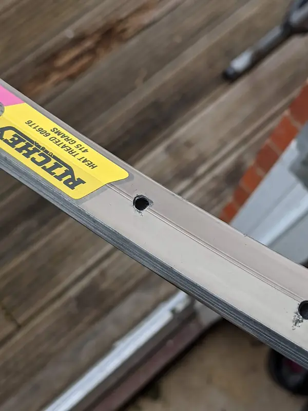

Ritchey Vantage Comp rims a little tarnished but true, and with lots of life left in them.
New decals have been put on following a polish, the colour is exactly the same as before (just the light playing tricks).
