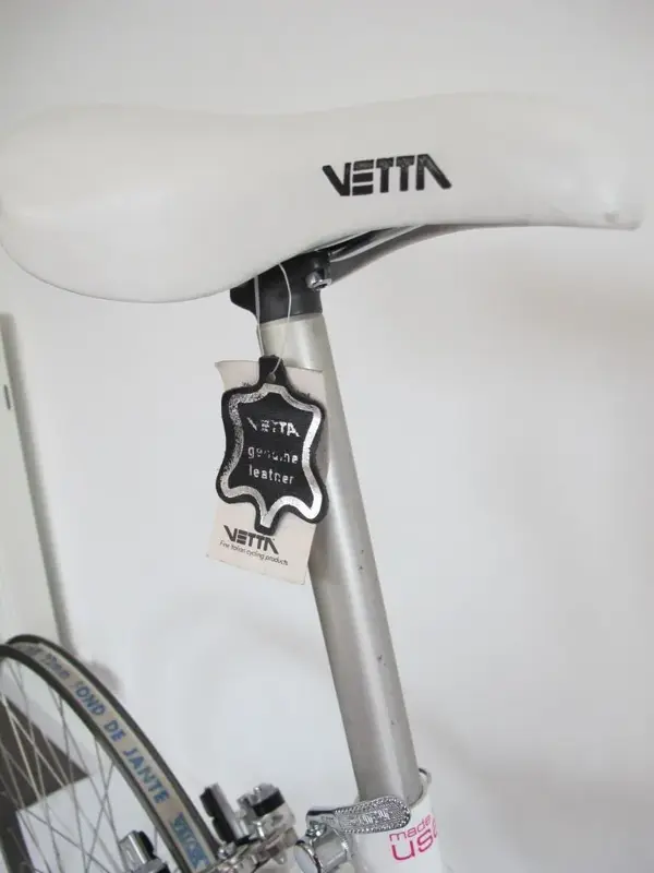

Last photo (for now). Seems a shame that it's going to get muddy but I'm planning on doing a couple of the RetroBike MTB rides this year. Vetta_1.JPG
