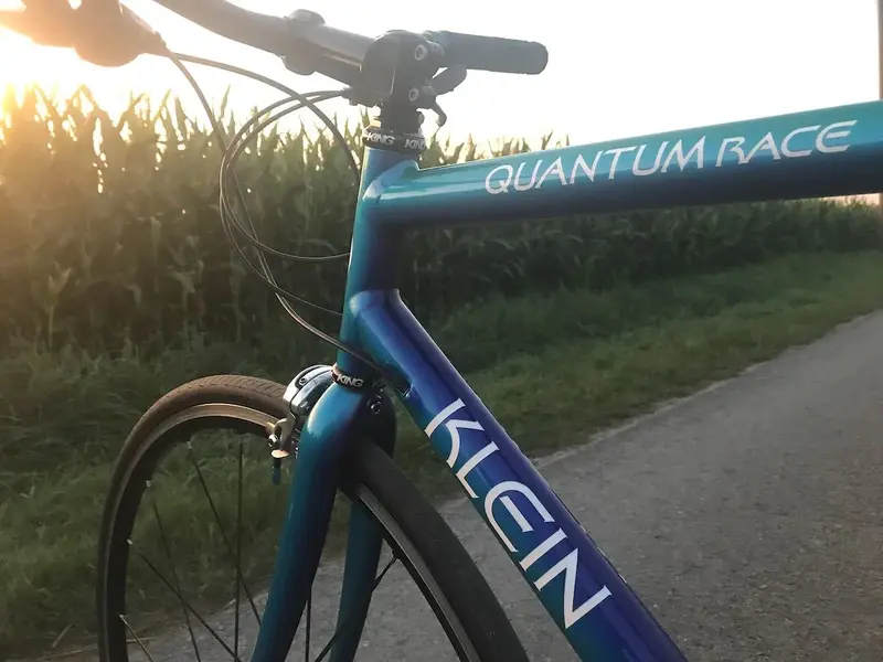

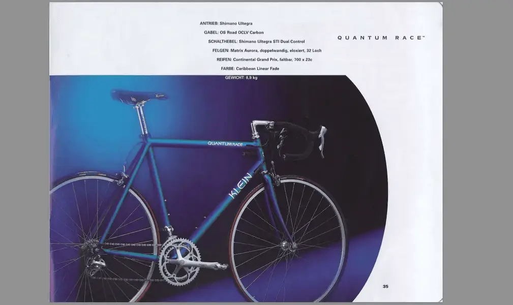

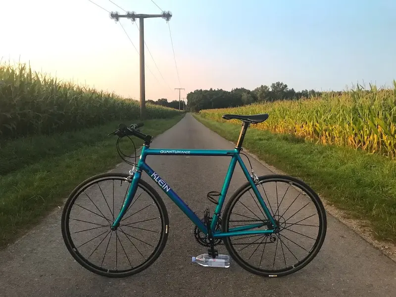

Nice find! I own more than 10 super high class KLEINs now of the 1990-1995 period. A beautiful 1996 Quantum Race (Color for that model and build year is called: Carribean linear fade) though was my first KLEIN ever. Back in 2017. Full TUNE parts / Dura-Ace build. Yours is an awesome save at a superb steal price.
