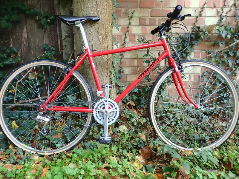

Bought this last year and it's been my winter workhorse pending a drop bar conversion in the Spring. It was already converted so I can't help in regards to the process, but as a 26er frameset with 700c it's a wonderful bike to ride. It has a character all of its own with the comfort and agility of a classic mtb and added pace. Definitely worth trying.
Whoever did the conversion physically relocated the rear brake studs, I suspect it was done by Overbury's as the fork seems to have been made for 700c, yet they match exactly the Pioneer forks from that time. Also it was bought in Bristol from the original buyers estate.

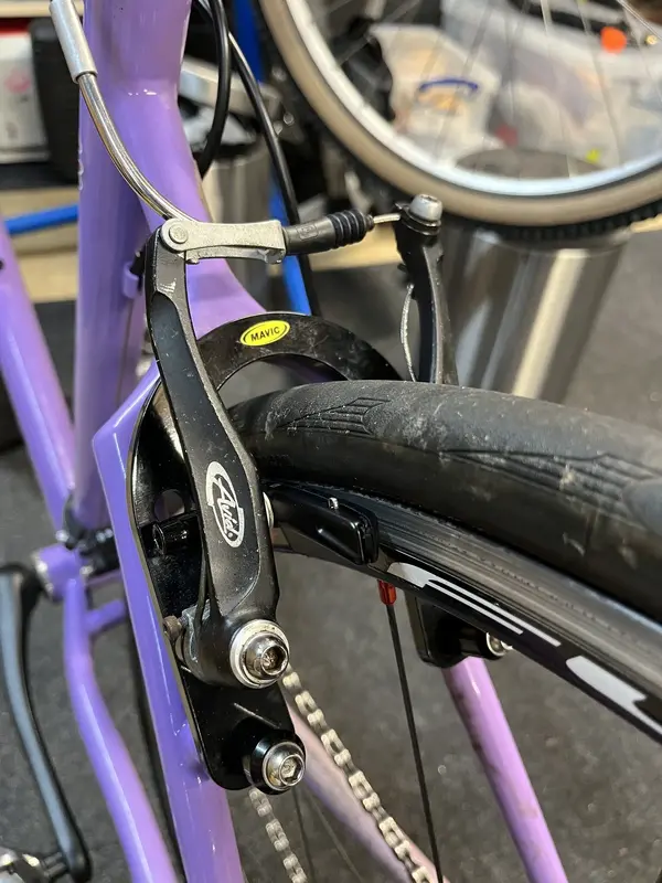

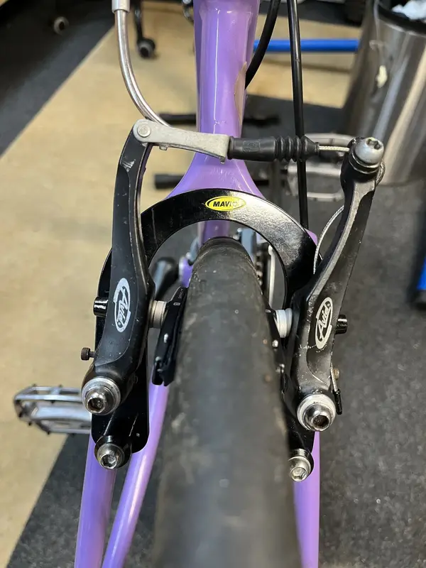

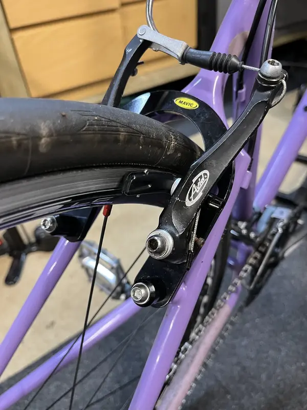

Those litepro brakes might be the way to go, thanks @spacehopper. I think the brake post extenders that have also been suggested are only suitable if the original brake posts are unscrewable. Mine are welded to the frame.
Some nice pics uploaded of people’s 26/700 bikes, thanks.
Being the childlike soul that I am I would have stickerbombed the adapter
I’m now having concerns over the non-central location of the Mavic one.
Oddly, the slightly off centre of the wheel doesn’t bother me as it’s due to the spacer to adjust 130mm hubs to 135mm frame. I know a steel frame would be ok, but feels wrong. On the positive side, just need to find some nice 135mm 700c wheels. 🙂
Why does it concern you?
