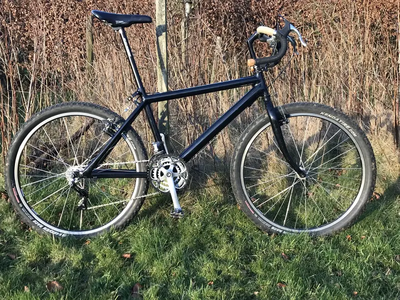

Nice. With the tall fronts, those Pioneer frames are ideal for dirt drops. I think the key point of such bars is the flare to allow a natural hand position and good control off road: didn’t the early Cunninghams use stock road bars bent outward to achieve this? Then you need to get the bar high so the flare is at the right level for most use; hence the LD stem as a practical solution.
The contraption I’m building is all sorts of contrary: an offroader trying to be a road bike but still with off road styling: so in that sense it is just “fashion” or perverse style. But it will offer plenty of hand positions to break the monotony.
I’d also agree that fitness and suppleness will be the master key to this - along with fuel.
I’ve almost got the MK1 built, and it already seems to be breaking the bar-at-saddle-height rule, so we’ll see how that goes. I’ll take it on a set course and Strava it so I can do performance comparisons alongside subjective feel. I’m expecting gearing will also take some faffing with (Sheldon’s gear calculator floats before my dream-addled eyes….)

So, MK1 built and taken for a quick shakedown ride.
First impressions?
1. “He’s an ugly little spud isnt he?”
2. It fits! The bar is is a little lower than I’d normally have for off road, but it’s higher than my road bike. Feels good so far; will need a proper ride to be sure.
3. It weighs in at 22.6 lbs at the mo. Not really light enough. I can diet the wheels, tyres, tensioner, BB, rear canti, and loose a redundant shifter. That should get it nearer a 20lb fighting weight.
4. Shifter on the inner bar will have to move as it’s a bit awkward for the extended ride planned. Will move it to the stem.
5. It flies and handles: again, will need to see what a day ride does to this impression, and whether the high BB really makes any difference (as noted, one of the oddities of this BotE geometry is a long wheelbase).
6. Gearing: currently 26, 36, 48 X 19. Too low. Middle ring spins out pretty quickly. Trial and error will be key, but I think the middle ring needs to sustain a comfortable 15mph and be capable of false flats and headwind flats?
7. Did I mention how it looks? will prolly have to get a bigger frame.
Hoping to get out a bit further tomorrow, but it’s 50mph gusts hereabouts at the mo ….. 🌬

Nice going with the weight and agree regarding gearing. I target 15mph as an average for mostly hilly dorset lanes with the odd bridleway/byway/white lane link. On my own with large off-road tyres(i am on 2.2 folding Race Kings(not race sport spec) it is hard work to achieve. i think aero starts really coming into play at 14mph, and from there it just gets harder, but I have gears to play with. Give a 17t a go with your middle ring, i reckon.
I use this website for gearing http://ritzelrechner.de/ as it is fun to use, seems to be very accurate, and you can compare some different setups.
Not sure where you are but there were flippin' strong SW winds in north Dorset, today. Same winds tmrw but not as strong as Storm Malik will have passed. There were some very strong winds and i am pretty sure Shetland lost both trees. Looks like there is another storm inbound but Northern Ireland getting it first.
Some easy and inexpensive lard reduction:
- loose the granny ring and the 5 bolts
- check some of the lightweight Schwalbe inner-tubes, about 100 grams for 26"
- replace the QRs for allen key style
Oh forgot. It's ugly, but who cares. Rear cassette may be a bit too close ratio? Something like 11-28 with a SS cage road mech may be better.
