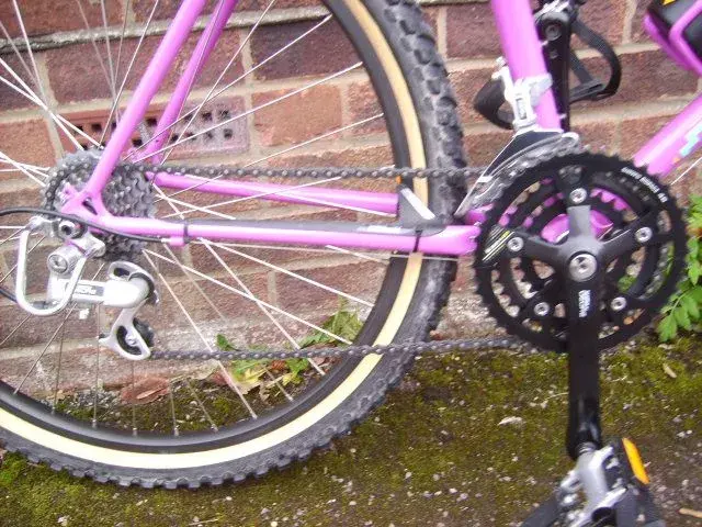

Oh man...
You're mocking me! Where did you get that picture of my bike from so long ago!!!
I've been trying to stay practical about this - but that just makes me feel like I'm being irreversibly, irresistibly dragged into something I didn't expect... namely to 'keep it original'. Won't that cost me a packet - and then make me feel guilty about using the bike for what it's intended?
How old is that pic? How does that bike look so new? Mine will never look so good!
thats how it looks right now, if you come along to mountain mayhem you could see it in the flesh!
Any idea where I might get nos black biopace chainset?
Only seen in chrome and is deore LX....
