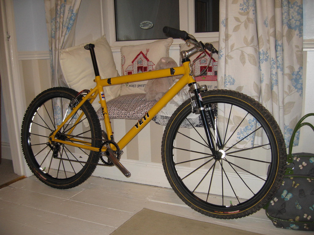

@ Merckx - Cheers. It's not at all finished, and in fact I've just changed loads of the bits :LOL: here's some photos.......
Added: Quadra 21s (though if anyone has some 1996 Judy SLs drop me a line!), Controltech stem, Gipiemme wheels, Panaracer tyres, Cro-Magnon cranks, WTB SST saddle.
