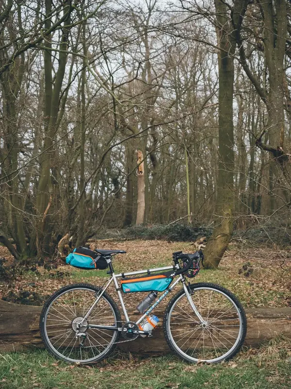

1996(ish) Marin Stinson - Adventure Rig
I think the bags have cost more than the sum total of the bike at this point! 😅

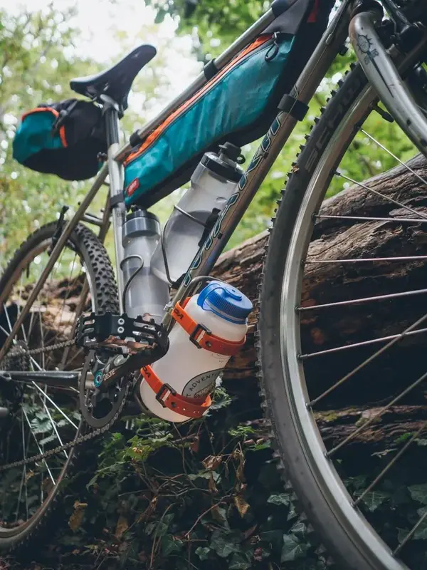

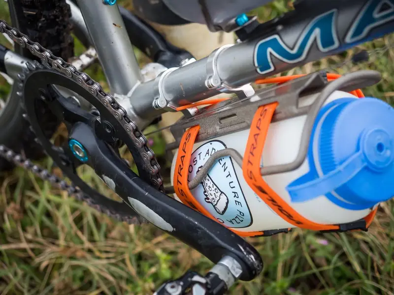

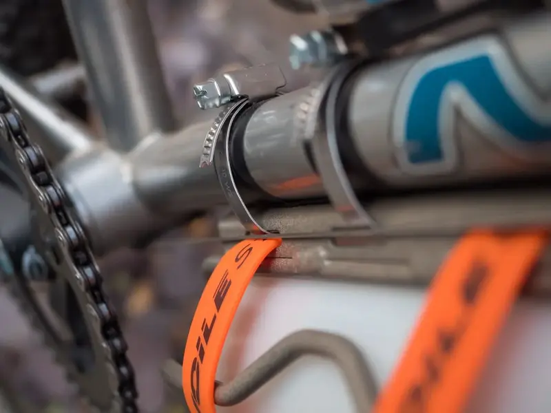

I ended up picking up a Blackburn Outpost cage. It's a little bulky, but it's built well and has slots to assist securing stuff to it, or in this instance, it to the bike using stainless steel hose clamps.
I have no doubt hose clamps provide a secure form of attaching stuff to a bike, however you'll see below the problems encountered with my particular set up.
For one thing, having the hose clamp and strap share the same slot space made fitting and removing the strap a chore. The main problem however was that the gear cable rested against strap and clamp. I considered just using a section of outer to 'sheath' the cable across this section to stop any chaffing / friction but I decided to reevaluate 'off the shelf' solutions.

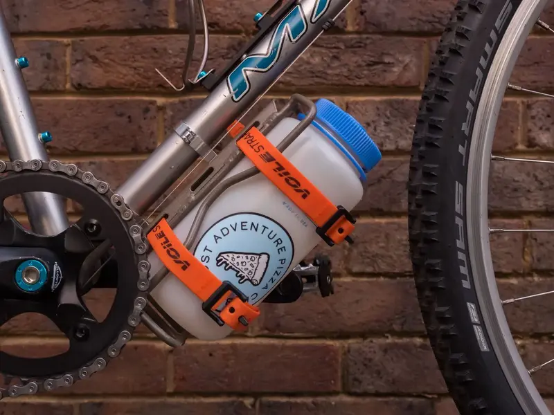

Later that week, I popped in to the local bike shop and who suggested these bottle cage clamps from Velo Orange (which look near identical to the DMR ones that RetroDavy suggested earlier!). The smaller size (28.6mm) is the same diameter as the down tube (according to my plastic verniers), thus a snug and tidy fit.
The gear cable now has an uninterrupted route and the extra spacing has permitted me position the cage closer to the BB (with the spacing affording a little extra clearance against the crank arm).

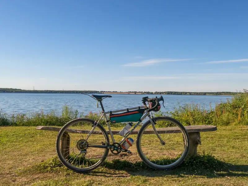

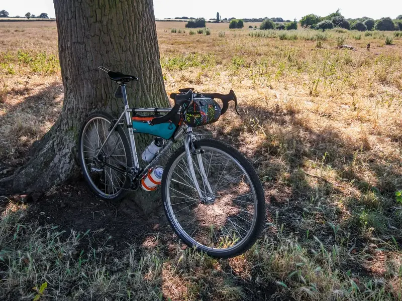

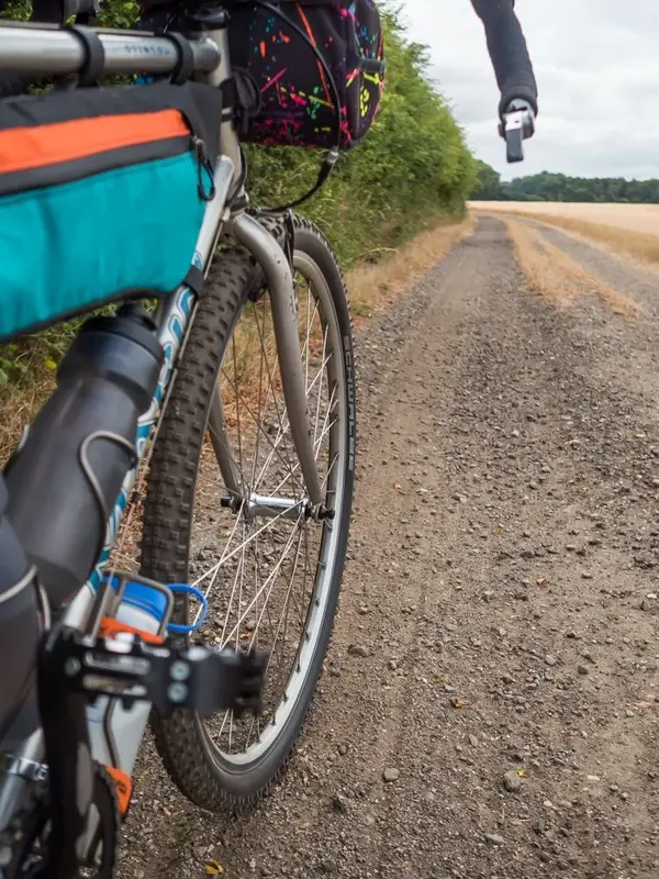

Last Saturday, I put the set up to good use and enjoyed a mixed tarmac / gravel ride to Grafham Water (about a 115km round trip).
Stupidly, I couldn't find my second bottle cage for the seat tube so I proceeded with 750ml + 1L in the lower cage, which wasn't nearly enough given the temperature.
One day, I'll actually learn...

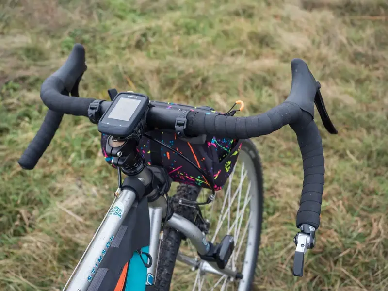

Speaking of chronic-tinkering, I am considering changing the handlebar set up. I have a spare pair of On One 'OG' bars which I think will work quite well, as well as a fair number of V-brake levers to choose from to complete the swap.
