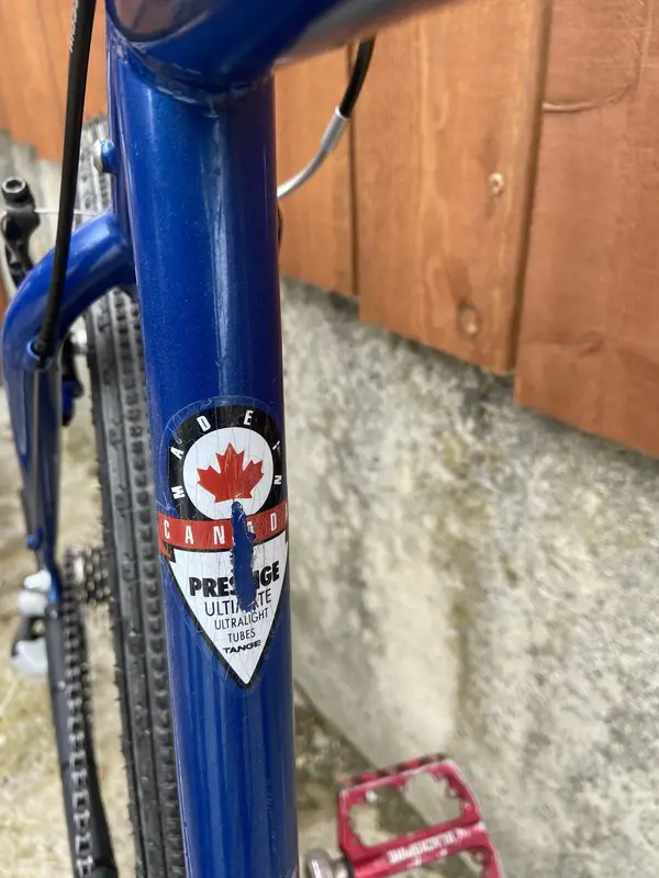

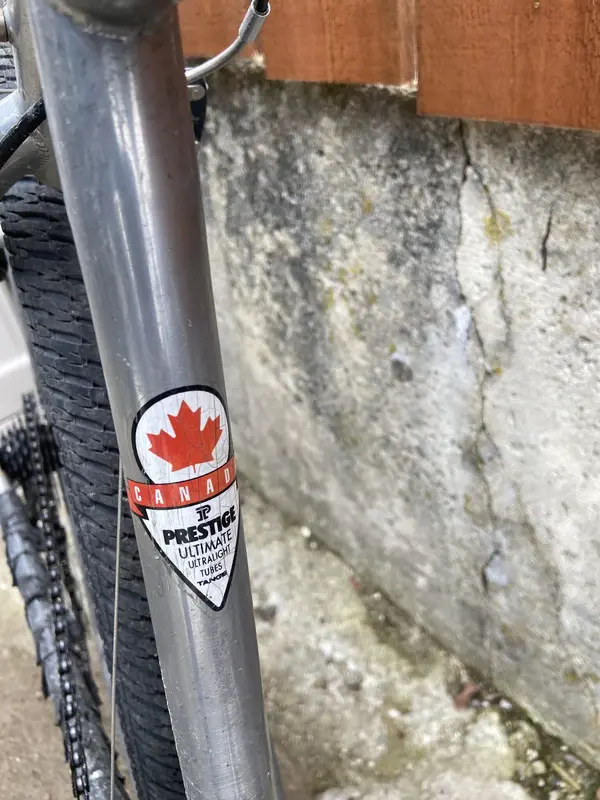

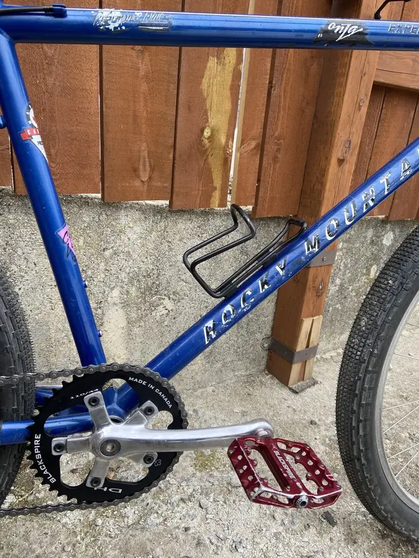

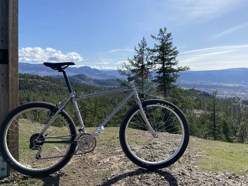

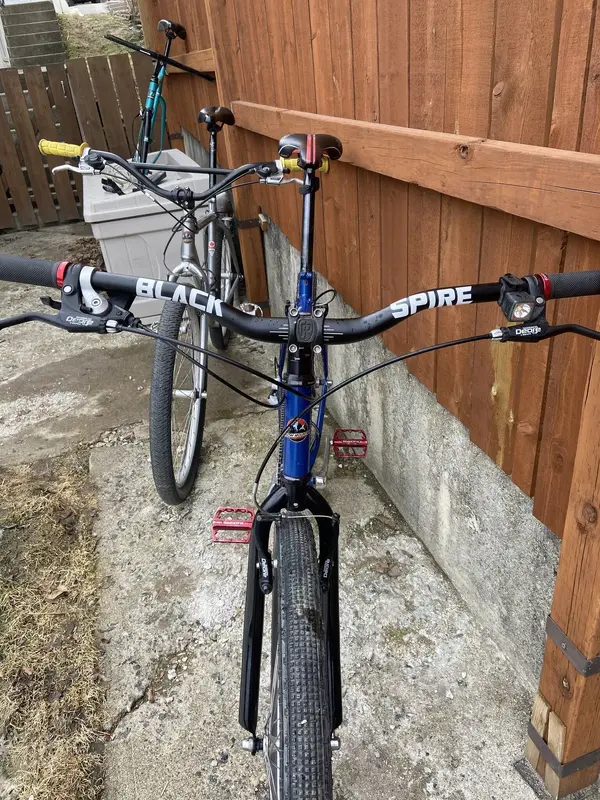

Hey folks -Greetings from Nelson BC Canada. I have both a ‘92 Team Comp, and am now building up an Expert, but both did not have the original forks when I got them. The Team Comp (photo below) has a spinner, and Expert came with a Judy that I’m replacing with rigid so my kid has a town ripper. Not doing a fancy build or anything, but does anyone know if they need a suspension corrected fork or not? How does one tell?
Suspension Forks are still brand new then (1992) and built for a rigid for frame, the aim was to not add a lot of height by design. Of any fork they would have had MAG21/10 and they are short. (though Scott of course...) so Either a 395 or a 405 would work and I doubt you'll notice much.

(The MAG21 had just been released this year Thanks super helpful. Have a 395 ready to install. Will post photos once built.

As Fluffy says- they weren't suspension corrected in 92 so 395 A-C would be your best bet, but it wouldn't be the end of the world if all you can find are suspension corrected.

The 20” Expert I built up is a longer serial#, F12AA0254 as far as I can tell (hard to read!). The 18.5” Team Comp does have the 4 digit #3688. The 395mm rigid fork I sourced for the Expert is a good match, and bike rides extremely well. The frames seem like identical tubesets, and as mentioned elsewhere, just the last rear canti braze—on on the monostay, is different. Thanks to you all for the fork advice!
