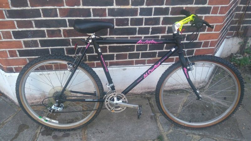

Scouring various outlets I came across a 1992 Cro-Mega LX that looked a half decent size (my wife has loooong legs) and I managed to pick it up for a grand total of £108.
A bit scruffy and with a mixture of bits but it rode nicely. However, I started to research and discovered Gil_M's decals for the Cro-Meg DX and some alternative colour schemes for the bike. A plan was hatched, all I needed was a DX group set and a bit of patience to paint it.

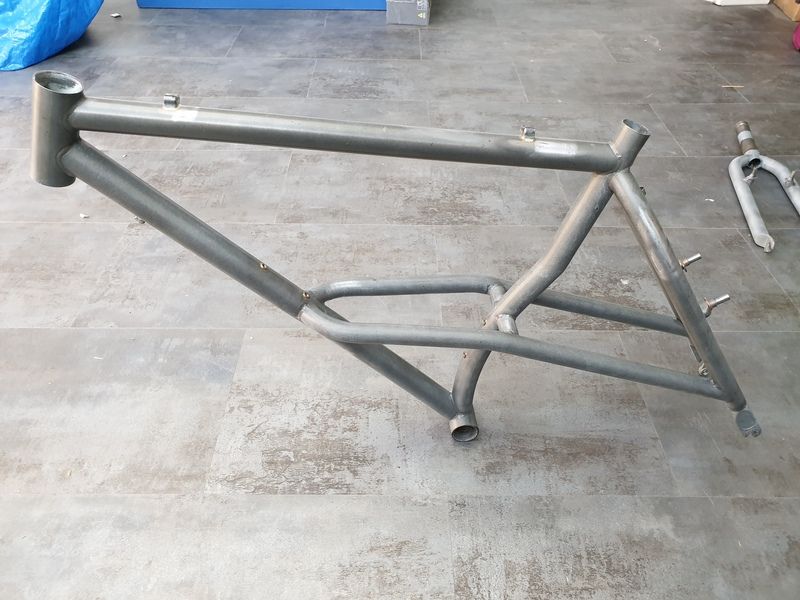

First job, strip the frame. This I managed to have done at my place of work using plastic media blasting. Basically sand blasting but it doesn't harm the metal - they can paint strip a coke can without any visible damage to the metal, quite impressive.

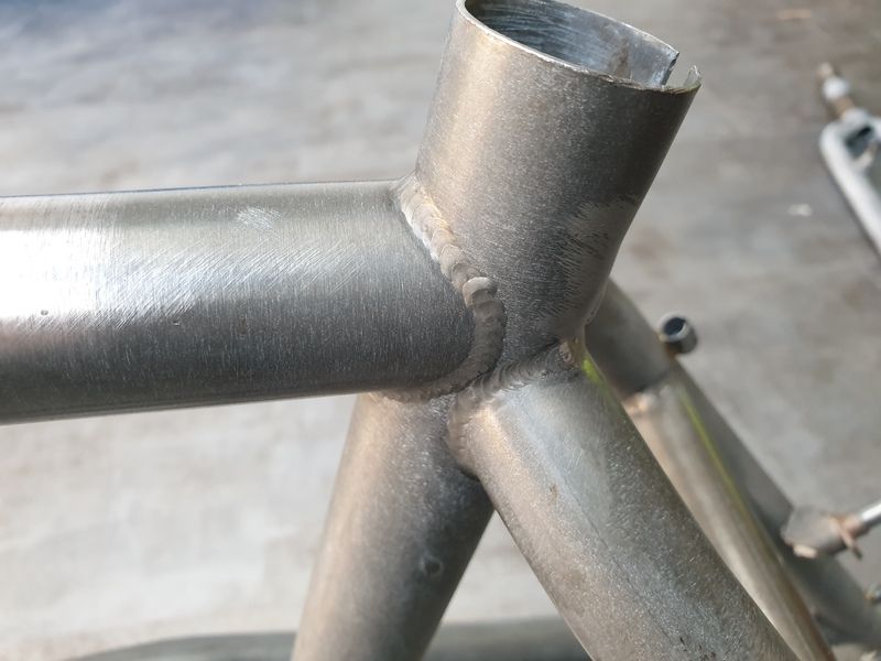

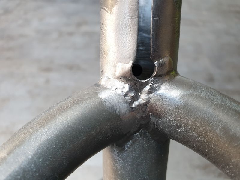

This initial strip revealed a crack at the base of the seat tube slot. Not a big issue with steel so I stop drilled the ends and had it tig welded. I elected not the grind the weld flat as it isn't in the way or particularly unsightly. Probably stronger like this too.
Other than that and a couple of small dents the frame looks to be in fine fettle.

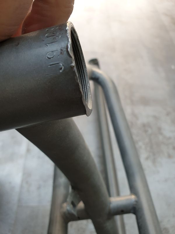

Some interesting BB scars...

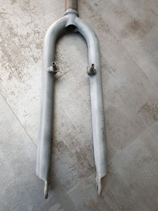

Forks

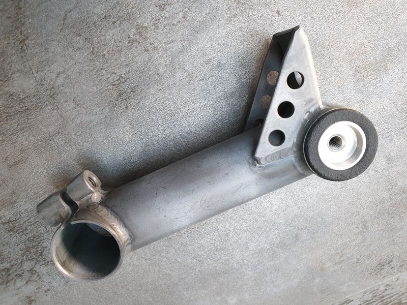

Stem (was fluorescent yellow....)

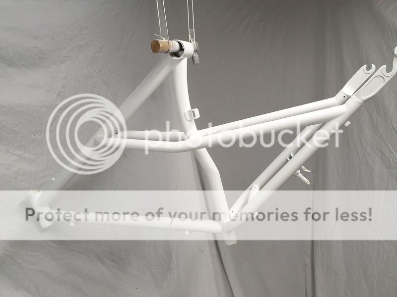

I've given everything the once over with white primer to stop the bare steel from oxidising in the damp air and will start masking out the paint job this weekend.

Are these frames renown for this or the result of a previous owner not having sufficiant seat post inside the frame, stressing the area. there doesn't appear to be much space for a long seat post !?
Not that I am aware of. There certainly isn't a lot of room to put a long post in, indeed, the post that came with it has been cut quite short but still appeared to be inserted down to the kink.
I think that either a post has been used far too high or, more likely looking at the scars on the back of the seat tube, someone had a stuck post and levered the split open in an effort to free it up....

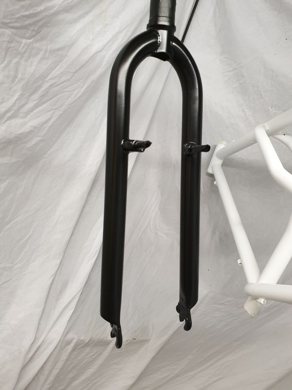

Forks and stem painted in gunmetal. It certainly looks darker than I expected but I imagine once lacquered and in the sunshine it should look a bit less black. The original colour, for bikes in the paint scheme I am using, was a plain grey.

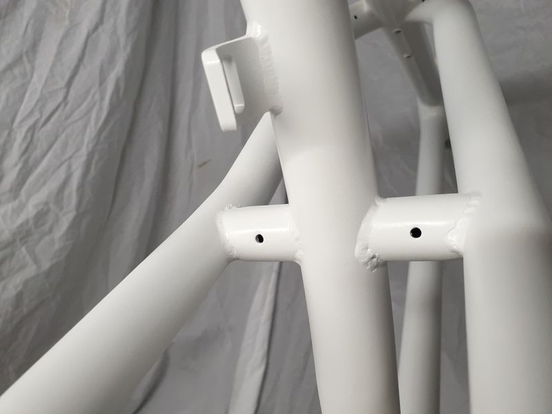

Frame primed and the centre sections painted in a white topcoat. Front and rear end to be Gunmetal once this layer has dried and I work out the positions of the decals that cover the colour change.

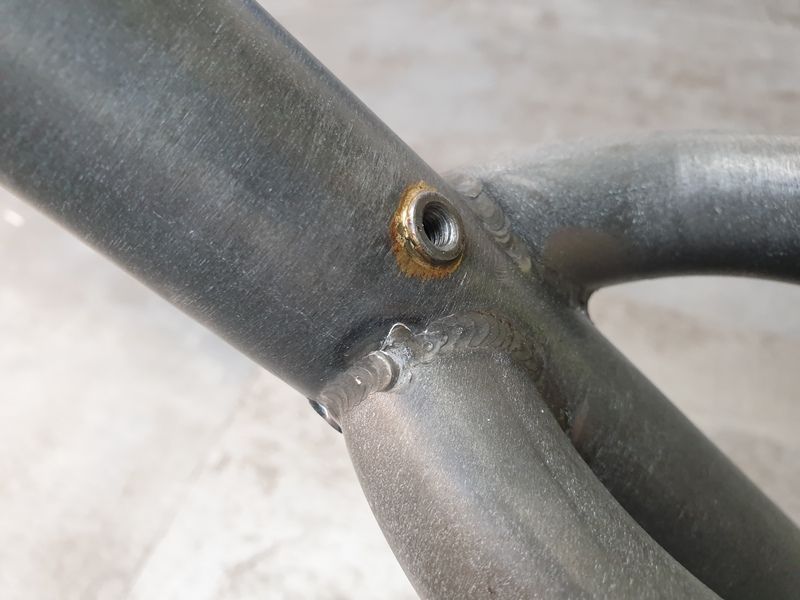

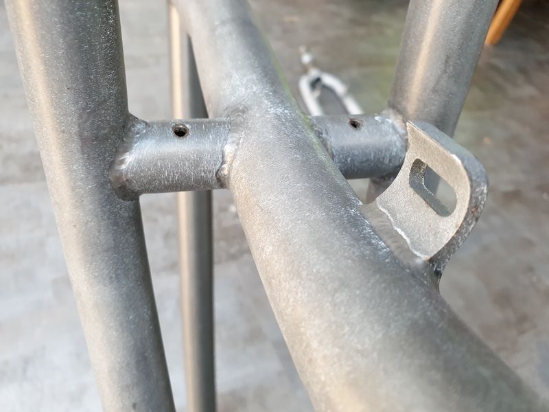

Not the prettiest original welds...
The "dodgy" clamp area...
