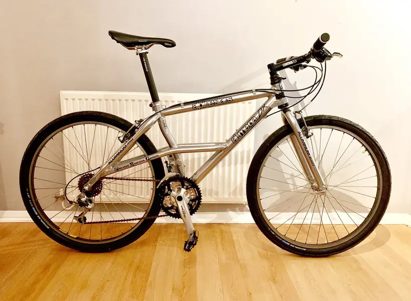

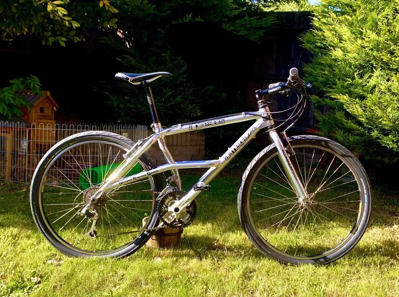

After having owned one of these from new back in ‘92 it became a need of mine to have one in the collection.
My original Al-Mega was a 15” that I had M735 XT mechs and thumbies fitted to before I took delivery, then fitted a set of Manitous and a flite and went off racing…
I loved that thing but unfortunately it was nicked off the bike rack a few years later and that was that…

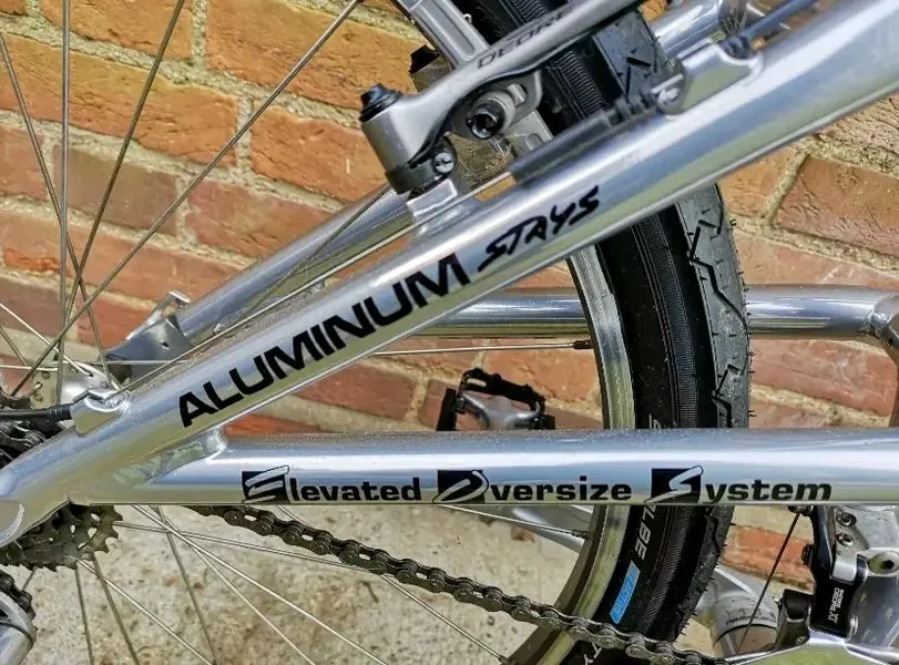

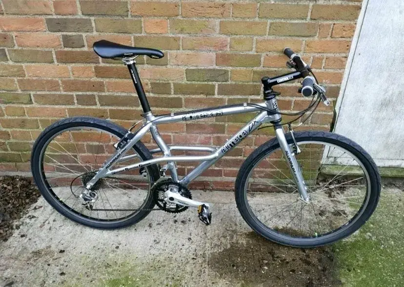

A chance flick through eBay back in 2018 brought up this little thing, a 15” (rarer than the usual larger sizes) with a total mish mash of components and what looked to be a polished frame!
After agreeing a very cheap deal I picked it up and quickly realised it was chrome powder coated, but importantly, fracture free!
I rode it a few times, just light stuff, tow paths, pub, shop and it always got admiring comments based on the quirky frame design and polished appearance, then put it away to come back to at a later date…
Last summer I decided to pull it apart and get stuck into the rebuild…A nice resto mod that I’ll keep forever! So, remember the bit where I said it was fracture free!?…

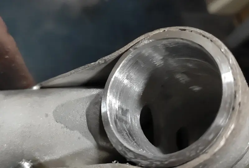

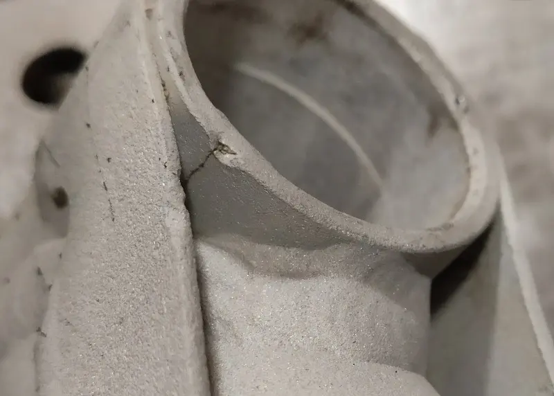

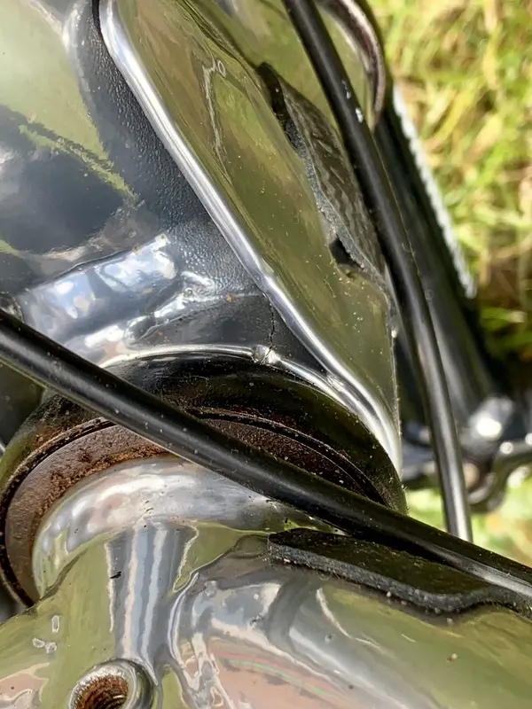

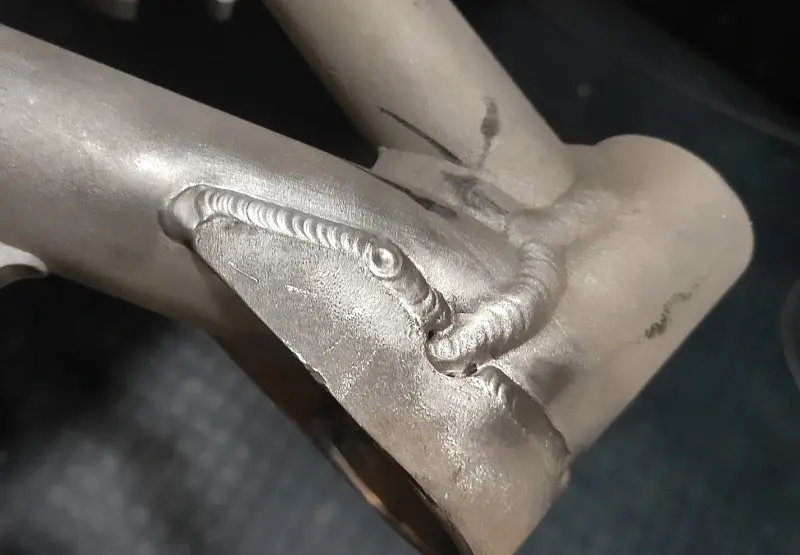

So…After the discovery of the crack on the headtube, on closer examination it seems it was caused by an over zealous previous owner removing the headset cups with a chisel!?…Probably around the time the frame was powder coated…
You can see the tell tale mark which the crack leads off of.

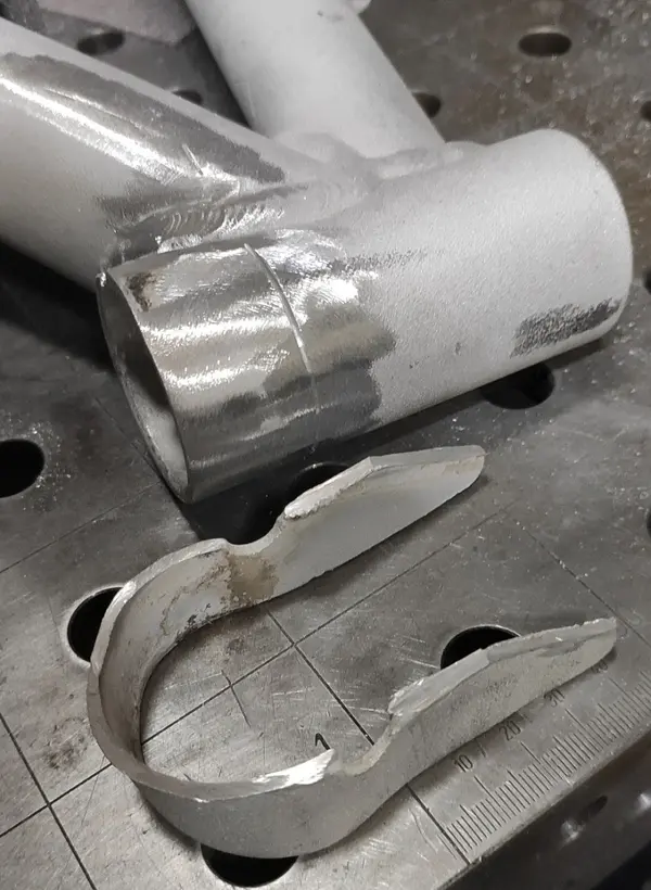

After speaking to Dan Chambers, it’s quite an easy and inexpensive fix. Dan will remove the lower gusset, invisibly repair the crack, fabricate and refit a new matching gusset and all will be as good as new! 💪🏼

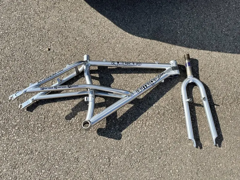

So it’s back from the strippers…

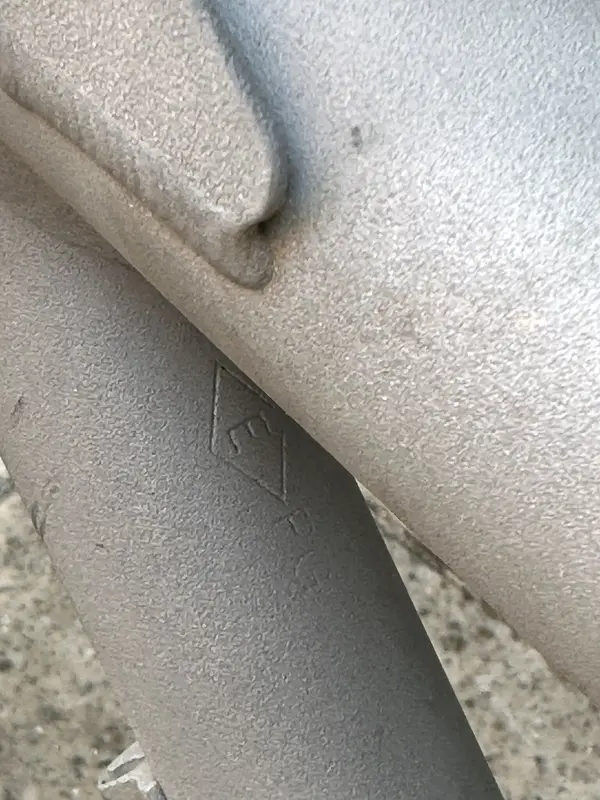

Other than the crack that I knew about, there are some odd marks on the down tube?
Anyone have any ideas?
All the Easton tubing marks are present and correct, but does anyone know how to decipher A-Stars frame numbers?
